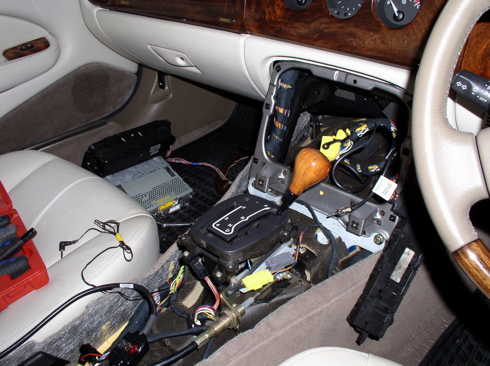

First remove the Centre Console .......
You may prefer Jandreu's suggestion.

If it does indeed involve tearing out the entire console then I shall indeed go to the boot
It does. Not really that hard, more of a PITA and time consuming, but if I can do it...
