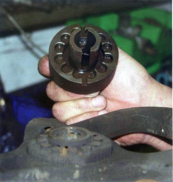

Here's the Jaguar tool for removing the ABS ring:
Unlikely your local garage will have this piece of kit available?

Oh no! A special tool is required = Jag dealer = they will refuse to fit the bearing I have already bought and insist on supplying their own
Old Sep 28, 2012 | 11:20 AM
Likes: 17,016
The ABS Removal Tool isn't cheap but it could still work out less than enjoying the ambience of Service Reception at Jaguar-Lille or Jaguar-Paris.
Here's a UK source at a rather frightening £204.00:
SNG Barratt - UK | Accessories | ABS Rotor Nut Socket
And a US source at more reasonable $150.00:
ABS Rotor Nut Socket Tool - 206-066A

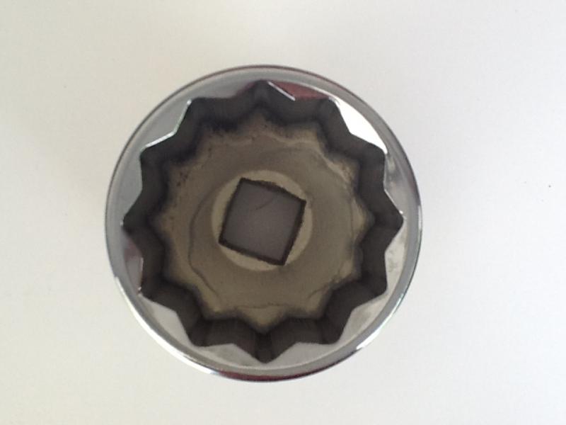

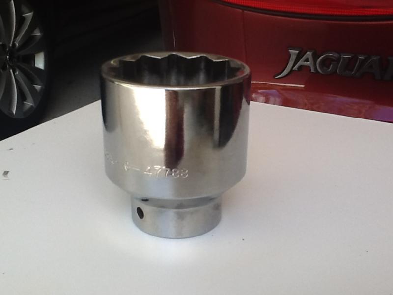

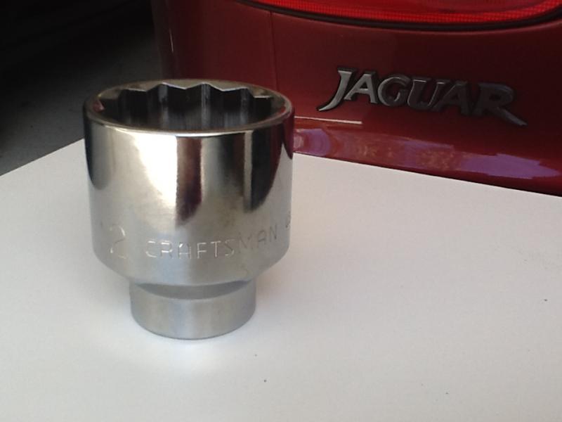

I changed both of my front wheel bearings on my 97 earlier this year. Instead of buying the ABS Rotor Nut Socket special tool, I used a 3/4" drive, 2" 12 pt Craftsman socket. My local Sears had it in stock for just over $20.
The socket fits nicely on the ABS nut, not as good as the proper tool but good enough in my case to do the job.
With the knuckle held firmly in a bench vise, I used the 2" socket attached to a 3/4" breaker bar with a pipe extension on the handle to free the ABS nut. I was able to use the same setup to properly torque it upon reassembly.
There are pics below of my socket & here is a link to the Sears site:
Craftsman 2 in. Socket, 12 pt. - Tool Catalog - Mechanic's Tools - Sockets
Beat of luck.
