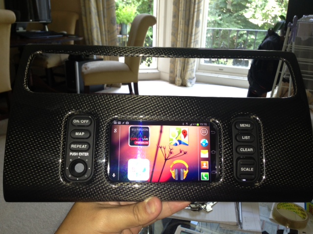

So I got my custom panel back from the shop. It's still needs to be CF.
The cutouts are oversized to allow for the thickness of the CF.
In the armrest I got a new lighter with a usb charger all neatly done. The USB cable charges the Note 2 when the ignition is on and also serves as a way to transfer data over.
On Monday the panel goes of the be wrapped so by next week I hope I'll have the finished product.
Pavlos

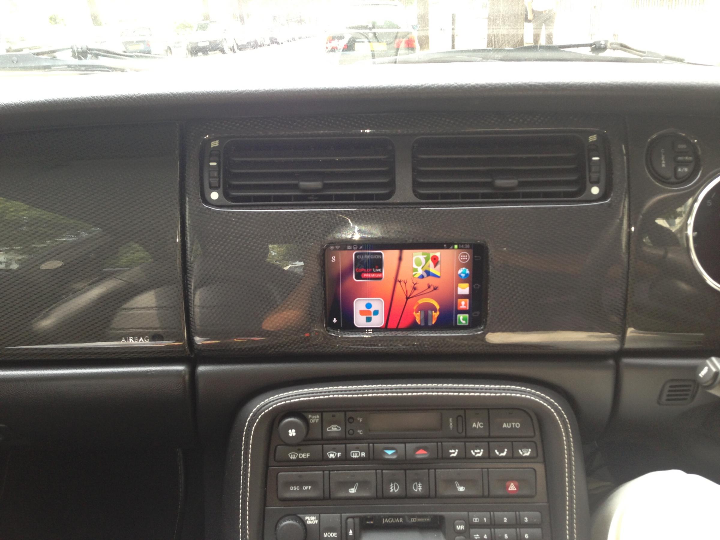

I have gotten my custom centre panel back and at last my car is complete again.
The general effect is pretty good, the carbon fibre weave even though not identical is extremely similar to the OEM one and one would have not either pay too much attention or know that it is not the same to tell the difference.
That said, the panel looks better in the pics than it actually is. Some parts of it are a bit "cloudy" not as clear as they should be and the detail work around the openings is not to the standard I was hoping.
I am probably going to test the whole install for a few months and if it is trouble free I'll redo this panel to a better standard.
All in all I am very happy with the upgrade and look forward to many miles of happy motoring with MP3 music, proper navigation and other features my note 2 can offer!!
Pavlos
Attached Thumbnails Samsung Note II in place of Sat-NAV-photo-1.jpg   Samsung Note II in place of Sat-NAV-photo-2.jpg   Samsung Note II in place of Sat-NAV-photo-3.jpg

Today I am really happy with myself
Not being fully satisfied with the custom CF panel made I was trying to think of ways to make the custom install look better.
The opening on the OEM carbon fibre panel is perfect for the Note 2 but the holes for the buttons where screwing me up (:.
But it had never occurred to me that the OEM Sat Nav can be taken apart and my Note 2 can be hidden behind the plastic fascia thus retaining a fully 100% OEM look with the original buttons!!!
Of course it would have been much better if all that had occurred 4 months ago and saved me £800 in the bin plus 3 months of driving with a hole in my dash but..oh well.
Taking out the cost of the custom panel this all could cost as little as £65 plus a note 2 contract which cost me £25/month (or about £350 or so on e-bay if you don't want internet in the car which I do).
Time wise its a 2-3 hour install at most even for the most DIY challenged people (me included)
If there are enough interested I can make a short write up.

Obviously the buttons are now just dummies and don't light up in the dark anymore (I am sure that would not be so hard to achieve) - plus I have to glue the joystick which was held in place by the main Sat Nav part.
if only I could somehow wire the on/off button to the Note 2 on/off that would be the best but that's way beyond my skills.
Attached Thumbnails Samsung Note II in place of Sat-NAV-photo-1.jpg   Samsung Note II in place of Sat-NAV-photo-2.jpg   Samsung Note II in place of Sat-NAV-photo-3.jpg   Samsung Note II in place of Sat-NAV-photo-4.jpg

Wow, you should be happy. It looks 100 times better with the buttons. Much more OEM, but more importantly it looks balanced now. Good job, sir.
