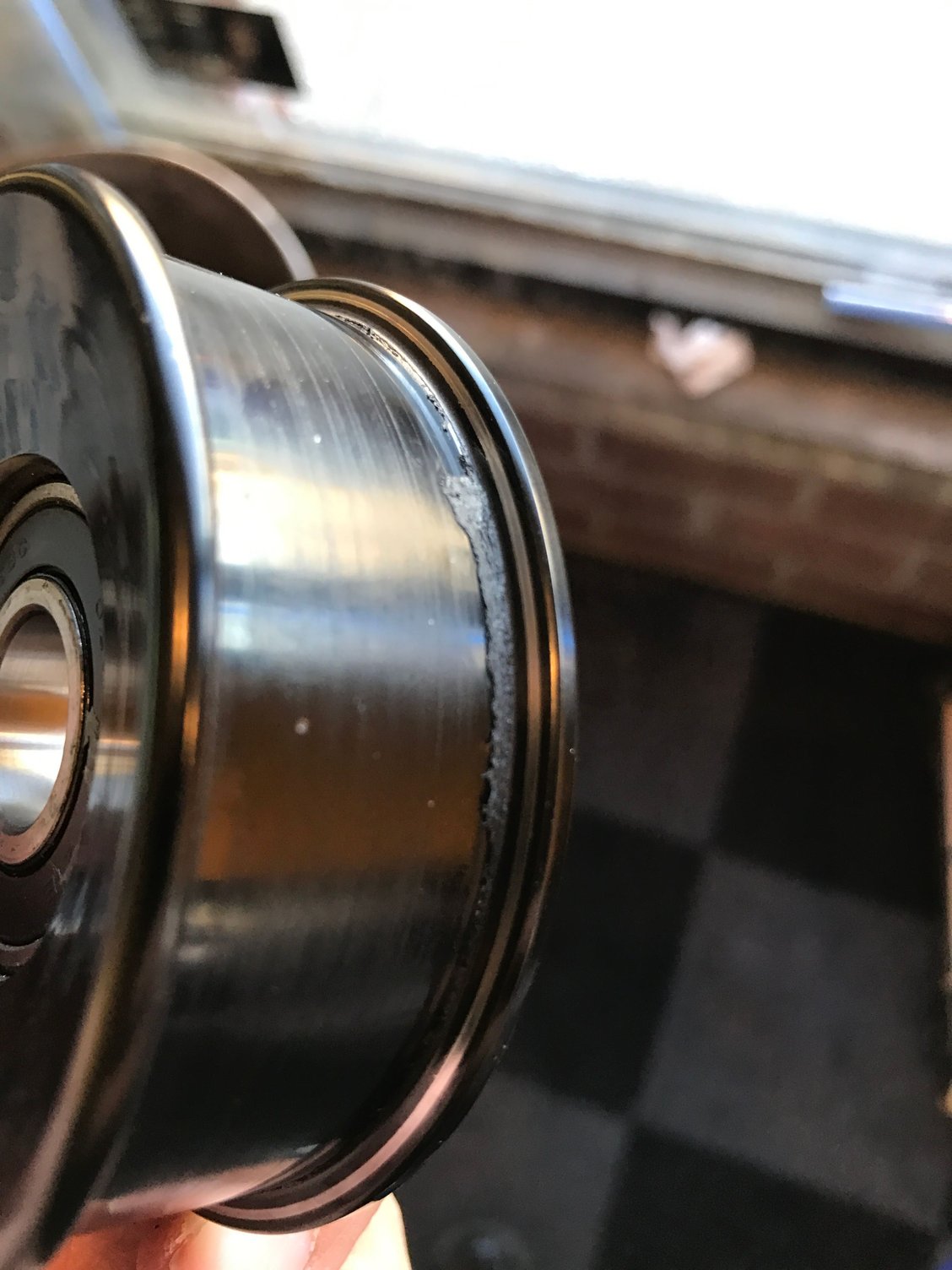

Yep, your story sounded oh so familiar.
Besides changing the belt, take a close look at your idler pulley. If I recall, you have a flanged one on your car. Change it.
The edge of the flange is responsible for cutting into the belt.
I put the smooth pulley on, and it's been fine.
Here's my flanged pulley..
See if you see this. If so, changing the belt isn't the only answer.

I'd go with Anthony's suggestion and change the idler and tensioner pulleys while you're in there.
Dayco 89016 (there's also a Gates equivalent) - around $20. OEM # is C2C22758. These are metal and smooth, unlike the original plastic part. Both of mine were grumbling, particularly the idler, at around 33,000 miles.
Note that the bolt through the tensioner pulley is a left-hand thread.

In my 30 some years writing service repair orders, I never saw a serp. belt fail on it's own. Something came in contact with your belt to cause it to fray. I concur with a iffy idler and/or tensioner pulley.
