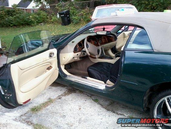

OK 19 HOURS OF HARD FU!#($%* Work!!!!!!!, wow, but here it is, just about completed. Thank me for bringing this CAT/EVIL CAT back to life !!!!!,Hood alignment completed.
I may say some things twice, but im tired and drunk, and did all this for the Forum

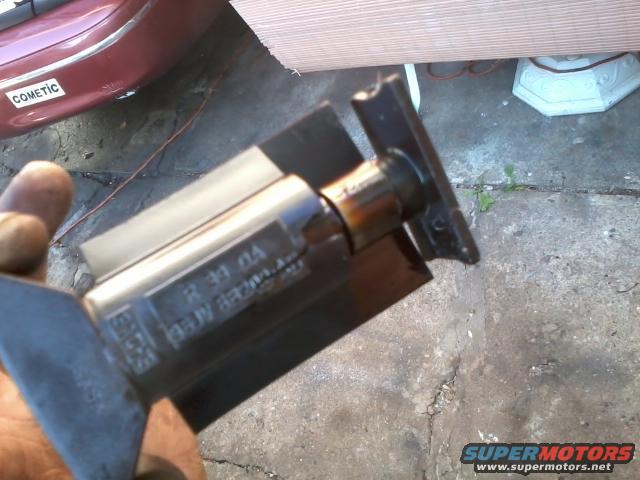

got the engine apart and back together, replaced these cracked tensioner thingies, whatever you call them, wow look at em, also sanded, repaired and redyed the door panels, carpet, and leather seat covers(custom)
Re-dyed the convertible top.
Changed The Oil,Spark Plugs, Coolant, Hydraulic Motor for convertible-NEW fluid, resistor mod next,changed all engine gaskets, soldered on new coil pack connectors, replaced all 8 coil packs,repaired fuel filler plastic latch,
shampooed the entire interior,polished and buffed existing paint,installed front pads, rear pads, all 4 new rotors,replaced broken e brake calbe, flushed all brake fluid-installed new brake fluid, changed thermostat and water pump,re-alined doors,cleaned maf sensor,installed new air filter, undercoated the chassis,applied dielectric grease to all sensor plugs to prevent moisture contamination,changed out all light bulbs.
Removed insects from the interior, buffed and polished wood grain interior, replaced all old fluid and several relays with new relays.
Balanced the tires and checked air pressure.
Set the clock to the right time and oiled the gears inside the clock with wd-40.
Attached Thumbnails Scored nice 1999 XK8 Convertible FREE ! !-0_1.jpg   Scored nice 1999 XK8 Convertible FREE ! !-0_1-1-.jpg   Scored nice 1999 XK8 Convertible FREE ! !-0_1-2-.jpg   Scored nice 1999 XK8 Convertible FREE ! !-1_1.jpg
