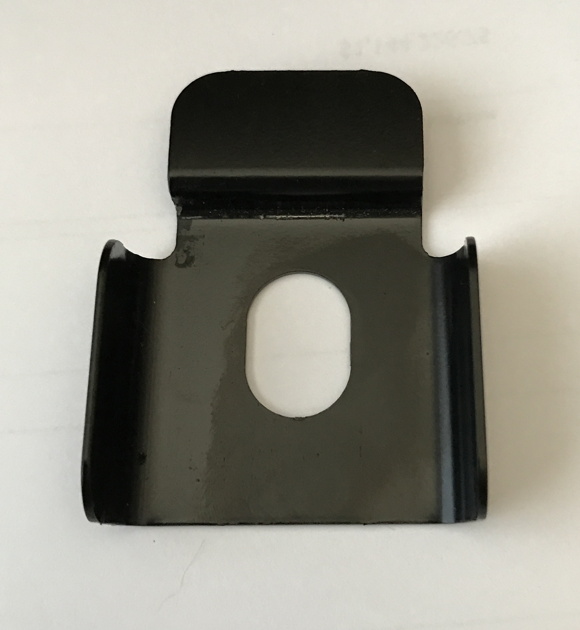

So I pulled the seat to look at wires. I cannot find any damaged wire but found this piece of metal under seat. Anyone have a clue what it is?

Looks like the spacer/guide(?) that goes on the seat rails. Not all of mine were tight when I removed my seat and one fell off. Just slide it back on to match the other side.
BTW, my fuse keeps blowing as well, but only when I sit in the seat. Otherwise it will work fine. I have gone through the wiring twice and can't find anything obvious. Even wrapped some wires just in case. No luck so far.
I am now going to look at the seat control module. I'm thinking that maybe it has a short that shows up when flexed by weight in the seat.
Let us know if you find the cure for yours.

yes that is it, just saw the one on the other rail
check my other post for the frayed wires i found, likely your issue
