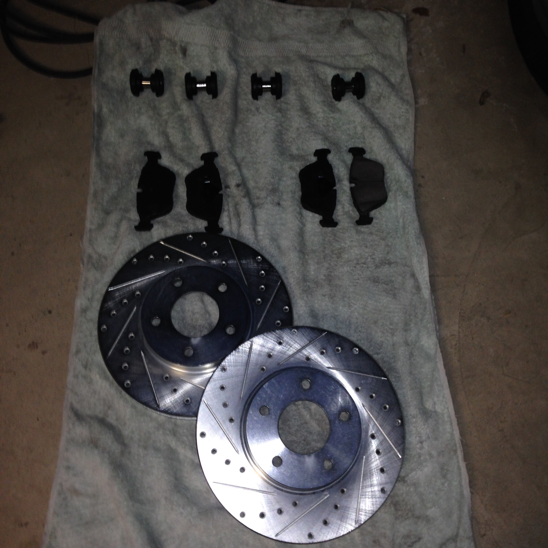

I'm coming back to this finally after much investigation and diagnosis. The lower ball joints have already been replaced so the big job now is to replace the control arm bushings which are loose on the passenger side and probably not too far behind on the other. While the wheels are off I'm replacing the front rotors with drilled, vented and slotted ones along with ceramic pads. The shaking should be remedied by the new bushings and that rotational unevenness in the brakes should be eliminated while I'm at it. I plan to do this on Monday morning so wish me luck.
