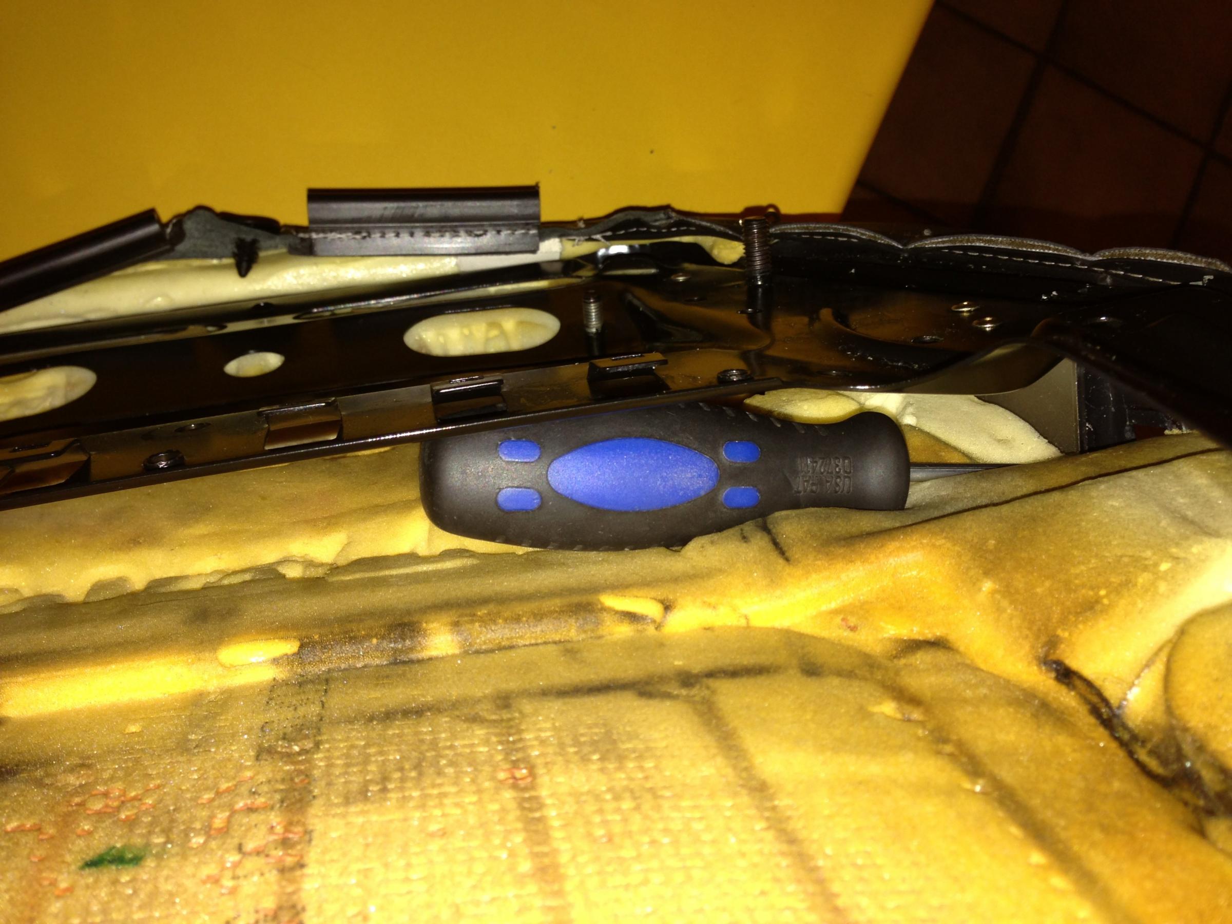

I did an exchange of my driver's side seat-switch column a few month ago. Ok, my seat's are a little bit different ( MY2004 with separate Headrest), but the fastening-hooks should be nearly the same. If the switch-column sits very neat, there's no chance to get it out without at least removing the seat, i think. And of course, the leather should not been scratched :-) In my case i had to disassemble the lower part of the seat.
You have to unlock one plastic-hook at the rear position of the switches and then they can been swung out while pulling back, so that the 2nd hook at the frontside is released. It should be possible to unlock the switches by pushing a small screwdriver through the gap between cushion and leather from the underside of the seat.
I've some pics attached to give a hint.
Greetings, Wolf
