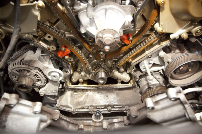

Old Jan 23, 2010 | 12:25 PM
  #72
viscoussquirrel's Avatar
Posts: 311
Likes: 13
From: Hawaii
Some pics...
This car was dealer maintained has had all services done since new. I have the records to prove it. It currently has 63k on it or so.
Notice the broken tensioner guide
I crammed a magnet into the oil pan to see what I might get. (I haven't pulled the pan yet) and found this lovely piece of timing chain.
