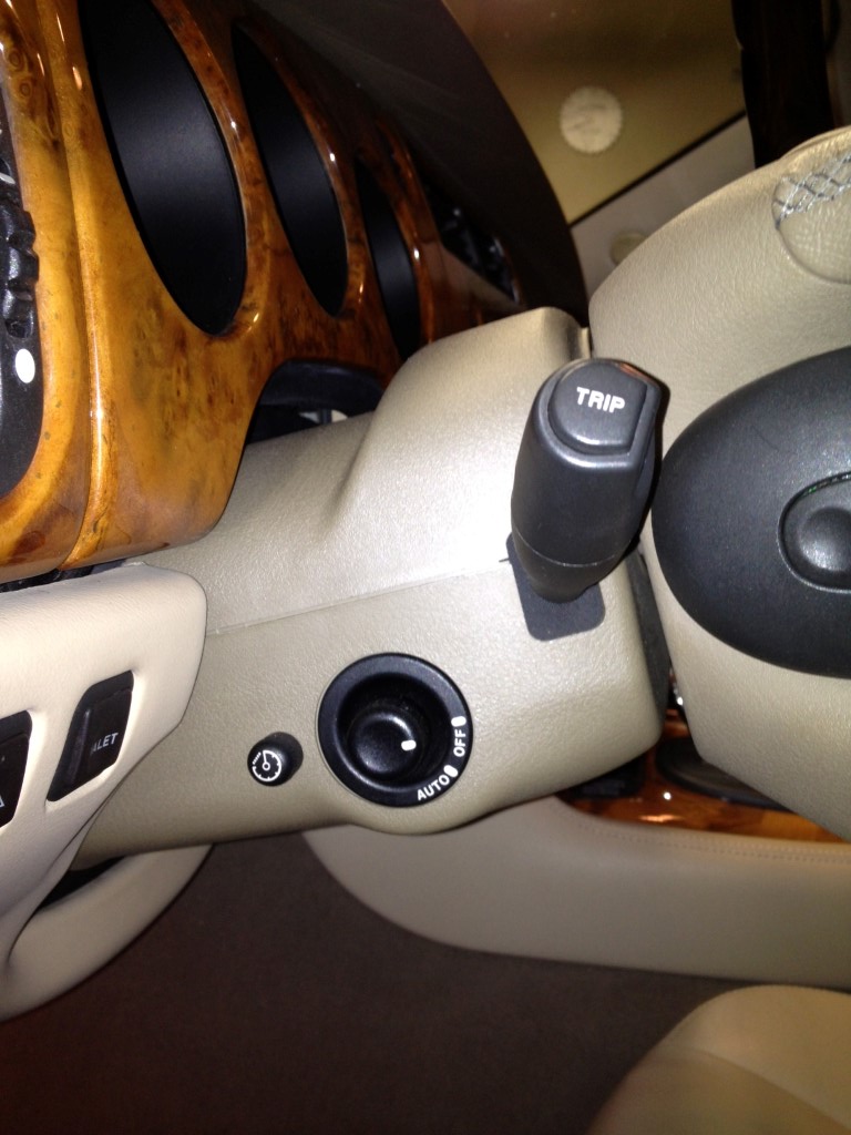

didnt look at the switch but i will now

Which position on the switch is "Automatic" ? Completely clockwise or counter-clockwise ?

Should be fully clockwise, but there is only about 30 degrees of rotation between the two positions.
