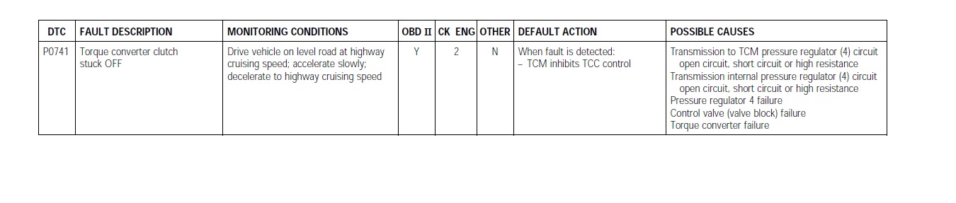

P0741 indicates Torque Convertor clutch stuck OFF. here are the possible causes:
