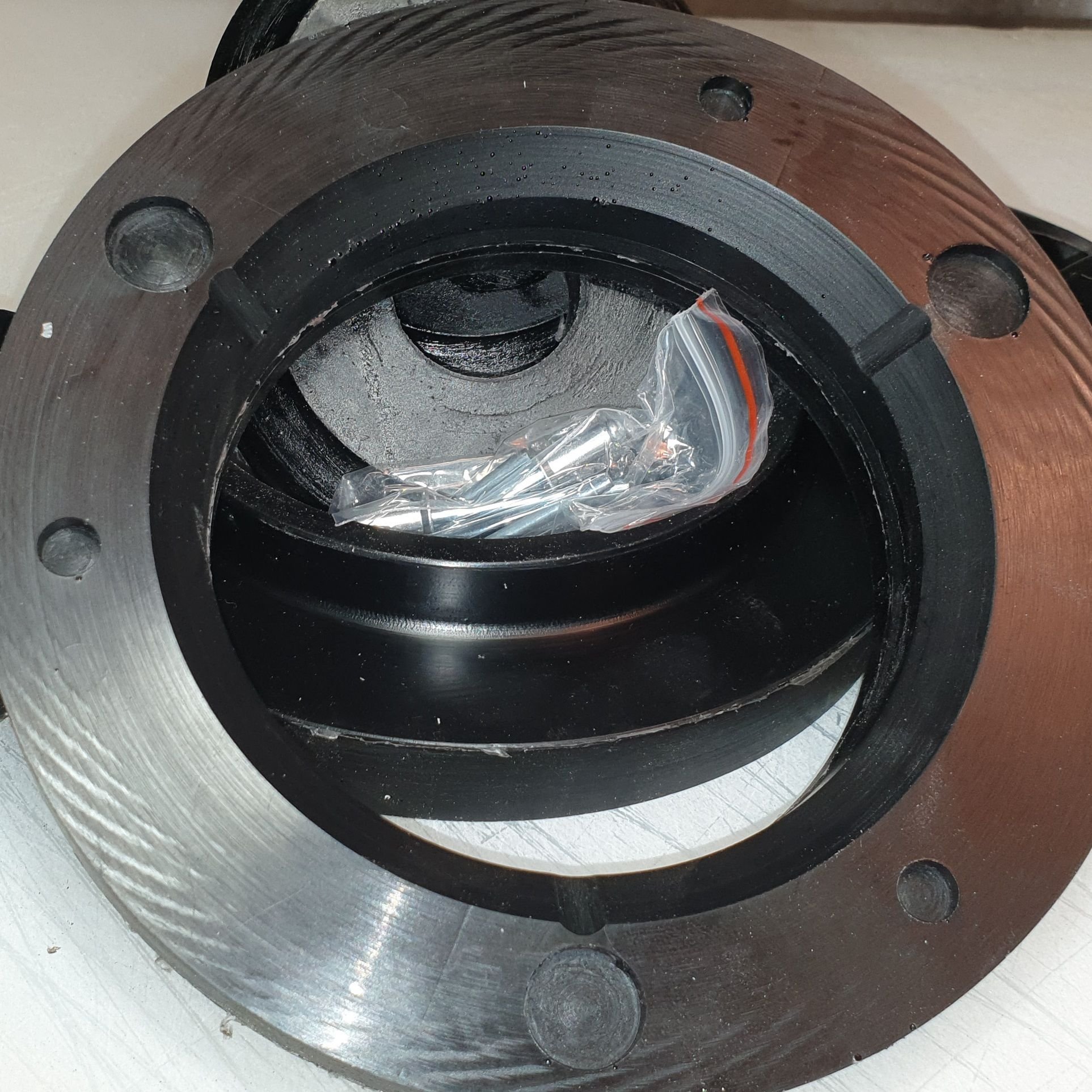

l have all poly bushes on front end along with my own poly top mounts.
Steers and handles like on rails.
My XKR has all the R options, including handling pack and 20" wheels and there was no noticeable loss of ride comfort. I cannot say if the same would apply with 18" wheel vehicles.
For the bushes, powerflex is the brand l went with.
My poly top mount also eliminates the common mount failure problem our cars suffer as a result of the foam components used. PM me if you wish to go this route.
