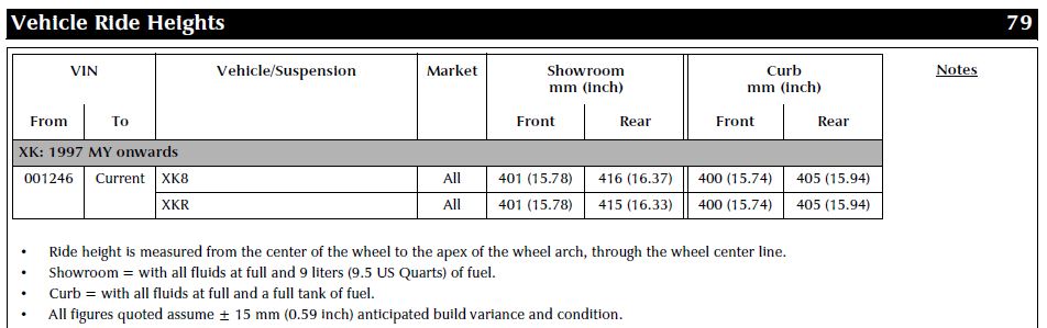

azeteg, here are my numbers and gas tank is 1/2 full
LF - 15.2 RF - 15.4
LR - 16.0 RR - 16.1

Is there a diff from the XK8 to XKR in front ride height? I've seen these numbers before and while the rear is in line, my fronts are 14 7/8" so they are a bit low, orig springs/cats... not a problem with clearance etc just curious if my springs were flattening out.
