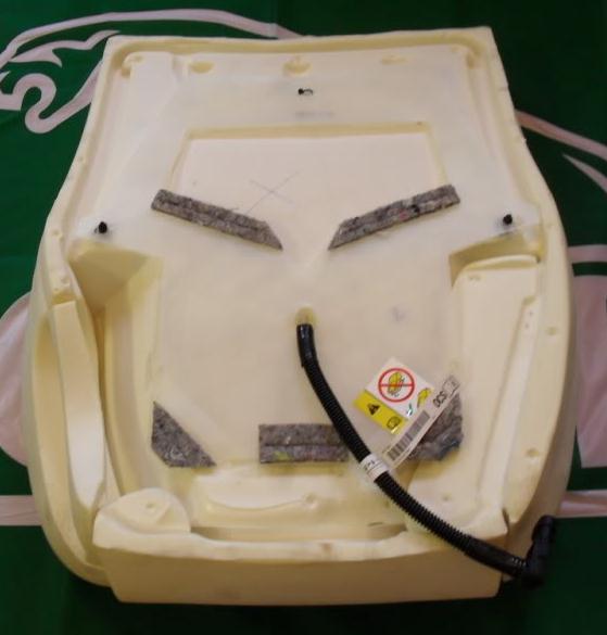

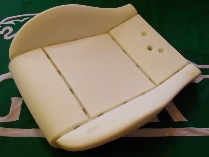

Once the seat base is set fully down there's no free space left underneath between seat and floor because of the motors and module. The only option to alter the existing seat appears to be fitting a thinner cushion pad. This is a Recaro pad but the standard seat is a similar one piece foam:
Swapping New Seats for Old Seats-xkr-recaro-seat-cushion-pad-1.jpg Swapping New Seats for Old Seats-xkr-recaro-seat-cushion-pad-2.jpg
It could be cut horizontally to remove approx a one inch slice, retaining upper profile for the leather cover and lower profile to match the seat frame.
Other than that you'd be looking at removing (most of) the electrics and fitting lower runners or fitting an aftermarket racing type seat.
