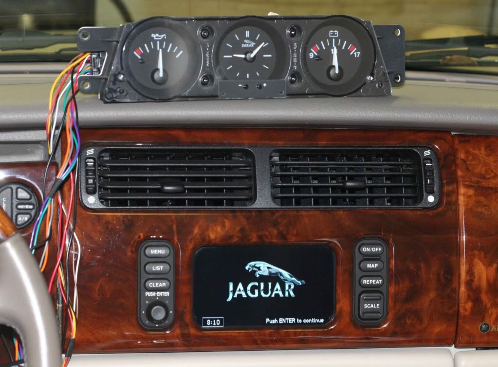

I have designed an add-on wiring harness that will facilitate the nav. to gauge cluster swap.
I am ordering parts now to build a few of these. PM me (or whitexkr@comcast.net) if you want one.
You off course still need to supply a cluster and the wood panel. The gauge pod fits in the same mounting holes as the nav. screen.
Just tested out a prototype:
