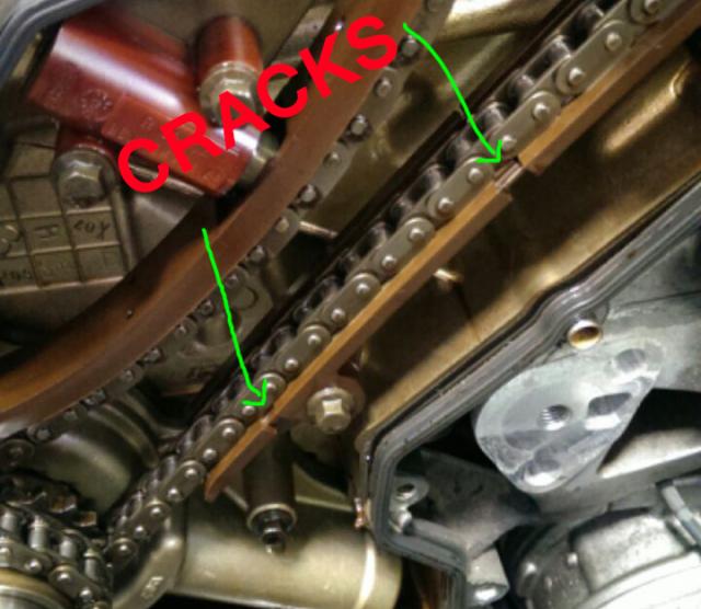

So Faith has been getting the full work over for a while now, my buddies give me a great deal on labor and in return I don't rush them....
So I set them up with all the parts for the UPPER tensioners, which are the orange original plastic ones, they haven't come off the car yet so I can't report their condition at 42K miles yet.
BUT, here is the warning-most of what I read on here says the lowers are rarely an issue and most people don't look them over unless there is some other reason to get behind the timing cover.
My mechanics pulled the cover and then summoned me to see this:
Needless to say we are now waiting on more parts. It seems to me that since these cars with the tensioner issues are now 12+ years old, regardless of mileage (mine has 42K on it) the lower timing system may also be suspect due to the plastics.
While I hate the money I'm putting in her now, I feel after this round of maintenance/upgrades I can drive for the next couple of years almost worry free, I hope!
Attached Thumbnails Tensioner Word of Warning-imag0109-1.jpg   Tensioner Word of Warning-imag0108-1.jpg

When I got the secondary tensioners replaced earlier this year, the primary guides were cracked as well. I ended up with new primary and secondary chains, tensioners, and guides. (And a lot more parts)
It was also a case of "while we are busy..."

When I did mine about six months ago, I figured while we're in there let's do everything, primary, secondary, timing chains, gaskets, the gauntlet. It all came in the one complete kit, and I didn't want to have to worry later on down the line. I think it's prudent thinking.

I must admit in the last 10 years of doing XKs I have never just replaced the secondary tensioners, I have always recommended to do the lot, I have always seen just doing the top tensioner as a "make do" rather than a proper repair/job

The only way to check them is to look. The secondary tensioners don't give any warning, they just go kaboom! The primary tensioners do give some horrid shrieking which lets you know they're on their way out.
I changed only the secondaries, because I'm on a student's budget. I haven't had a problem yet and avoided having to shell out a small fortune to a mechanic. Would I do the primaries if I had the chance? Yes. Would I prefer to have done them both? Yes, but, I would still do them myself. I love tinkering on my car. I do feel a huge relief even though I only did the secondaries.
Next year I'll have more time and hopefully more money. I might take the plunge and work on the primaries after I have swapped shock mounts and transmission oil/filter and dealt with a fuel smell. It's been about 5k miles since I changed the secondaries and I haven't had a single problem.

My mechanic convinced me to do the whole job, and boy oh boy, am I glad I did. The prior owner(s) changed only one of the secondary tensioners, and nothing else. take a look at the link for a pic of the parts removed with my total job.

I have been told by many Jag owners that the primary tensioners rarely go out, so I only changed my secondarys last year with 90,000 miles on the XK8.
My daughter borrowed it 6 months ago and the serpentine belt broke (only 6-months old and the best that Gates had to offer), and she didn't stop the car until smoke was rolling out of it due to severe overheating and a broken radiator hose.
Well, just last month the head gasket blew (common after an overheating episode), which gave us a reason to check out the primary tensioners.
They were severely cracked.
Total cost for everything including head inspection and resurfacing, gasket set, primary tensioners, fluids, and labor (at $45 per hour/ retired ASE) came to $1,700.
I can only imagine the extent of damage that would have been done if the primary went out.
A good investment...don't wait for an excuse to check them out.

Just had mine done. The plan was only do the secondary tensioners as the car only has 32K miles on it. Turned out the secondaries were fine but the primaries were cracked. So we did the whole process, obviously. Also found a cracked valve cover. Asked the tech if the valve cover was due to improper torquing, and he said it was more likely age of the material.
