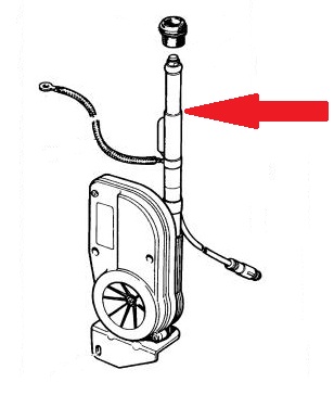

Old Feb 18, 2013 | 06:17 PM
Originally Posted by Sentinelist
.............. I just looked to see if the motor can be pulled whilst leaving the mast in place- that may be the route I go............
Cut through at this ridge leaving the stub attached to the wing and discarding the remains of the motor section......
Is there a plug for the antenna hole in the fender if the motor is taken out?-amputate.jpg
You can't be doing this for weight saving so presumably have plans for the space currently taken by the antenna and CD unit?

Thanks, Graham (Mike too), that's a good idea. It's not weight savings per-se, there's just no reason for it to be there if it will never be used again. No plans for the space back there.
