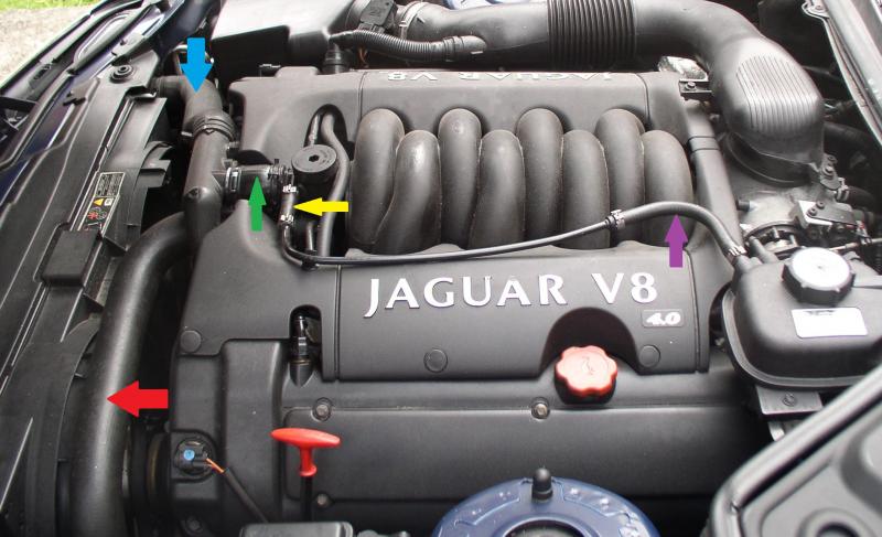

+1
I couldn't exactly decide which hose either.
The Yellow arrowed, Purple arrowed or Green arrowed?

Both of them are hot. The small 3/8 hose busted. It doesn't leak. It's more of the pressure building up and causing the hoses to bust. The three inch hose gets extremely hot as well.
Old Oct 25, 2012 | 01:37 PM
Likes: 17,016
Looking at the pic in post #7, the yellow arrowed (Bleed Hose) and green arrowed (Bypass Hose) should get too hot to touch as should the black plastic Thermostat Housing.
You've replaced the Thermostat so there should be no possibility that is sticking. Without removing the Water Pump you can never be absolutely certain about the plastic impeller blades but actual breakages seem to be relatively few except on the early cars.
If the system is building up excess pressure, the next possible cause to investigate would be a faulty Expansion Tank Pressure Cap. There have been several report on the forum of these failing. The Cap has to open to allow excess coolant from the Expansion Tank to flow into the Atmospheric Recovery Bottle behind the front wheel arch liner.
