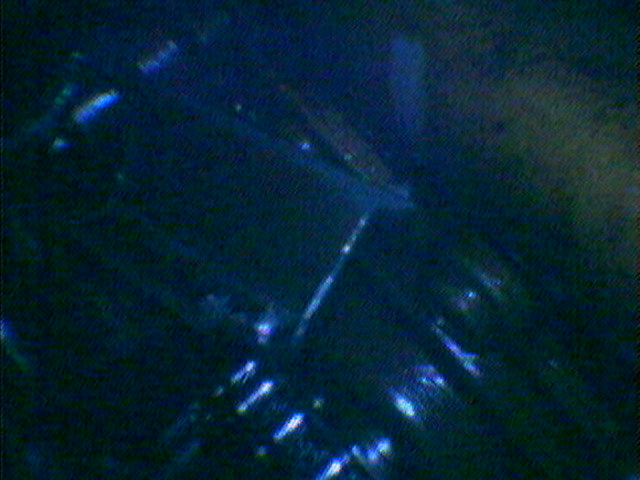

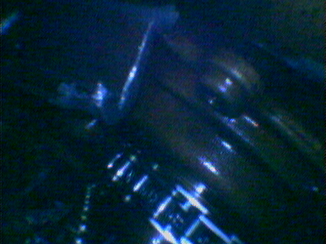

Default Pics of the broken primary tensioners
I replace the secondary tensioners, and i took a look with the borascope camera, this is what i found, the right bank primary tensioner shoe is laying at the bottom of the timing cover, half of it is laying across the primary chain, and all the shoes are cracked, both banks, pisser, now i got to tear it down, i was hoping i could wait.
