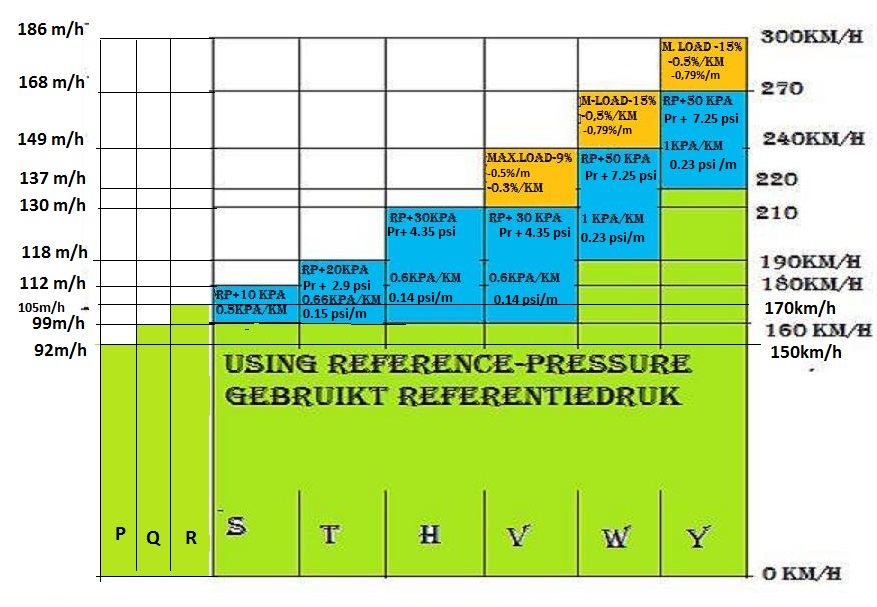

first thing that is not totally correct is the 50 and 51 psi maximum pressure.
A standard load P-tire always have a pressure needed for the maximum load , up to 160km/99m/h of 35 psi ( EUR tyre 36 psi with exeptions to lower).
A XL/reinforced/Extraload P-tire this AT-pressure( as I will call it furtheron) is 41 psi ( EUR 42 psi with exeptions). On sidewall is given for those tires maximum allowed cold pressure , and difference is used to highen up the AT-pressure for higher speed.
LT tires only give AT-pressure on sidewall, if its given , and so maximum allowed cold is higher. Most American tiremakers allow 10 psi higher then AT-P. Seen in Eur document 1.4 times AT as max allowed cold.
Then second is your calculation, havent checked it , but probably lineair calculation. Not that bad but if you would use the ideal formula to laws of nature, wich I determined in time, it can be lower pressure for same load.
So forget all the pressure/loadcapacity lists and only go from maximum load, AT-pressure and speed you drive and wont go over for even a minute, in relation to the maximum speed ( or speedcode) of tire.
Then looking back in old american lists you will get higher loads , because up to 2006 the calculation was different in America. and still is now for LT and TRuck tires. Leads to higher loads for the pressure, or other way around, higher pressure for same load.
Added a picture I made to show what acording to the EUR system I got hold of , the AT pressure has to be highened up for speed, different system for different speedcodes, and even maximum load lowering for speeds from 30 km/h below max for V,W,Y tires.
