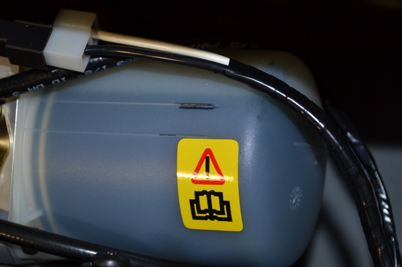

Well I just finished dinner and thought instead of beating the dog I'd beat the dead horse
Attached are pics showing the fluid level in the pump reservoir when the top is fully closed (that's the pic where the fluid is even with the top hash mark) and fully open (the fluid level is above the top hash mark). Ma! is the horse dead yet or should we keep beating this thing? Ah, it's great we have the freedom of expression---now let's go watch the Olympics.
Attached Thumbnails Top Fluid Level Discussion-jag-pump-8-1-12-006-800x533-.jpg   Top Fluid Level Discussion-jag-pump-8-1-12-007-800x533-.jpg
