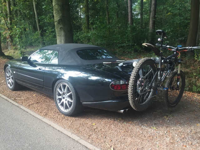

The XK8/R hasn't been homologated for towing, so there are no specs, that alone makes it already illegal here in the EU. Am not religious in any way on what one should or not, as I could have used a (removable) towing bar myself for carrying my bikes, now I use this:
