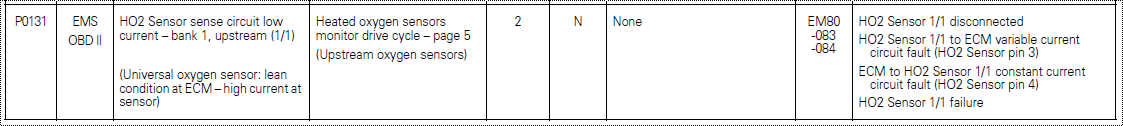

Your P0131 indicates a problem with the upstream O2 sensor on the right side. Perhaps it was disconnected or pinched during the transmission installation. That could also cause a P0171 code.

Thank you . I agree - I did clean the MAS and the throttle body. and reset the ECU. Wow! Did that make the engine run super smooth. However after about 25 minutes of town driving the codes came back. This time however the engine fault and decreased engine performance did not display. I now have a check engine light and codes P0171 and a pending fault P0131

i ran an OBDII test again and it looks like sensor one, bank one is flat lining. I'm going to replace that and see if that solves the problem. all of the other sensors look good.

BobRoy has been an amazing help. Without him, I would not have been able to fully replace my transmission for less than 2k which I think exceeded my expectations. In addition, I have ordered a new o2 sensor (bank 1 Sensor 1) and will put in in when it arrives.
