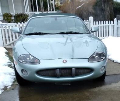

Me and the misus are driving a well taken of 2001 xkr from Redding Ca to Lubbock Tx. Any advice?
Route? What to bring along as far as tools? What kinds of baggage will FIT? How to prep the car? How often to stop?
I know it's a broad question, but we have owned jag sedans, but not a convertible.
