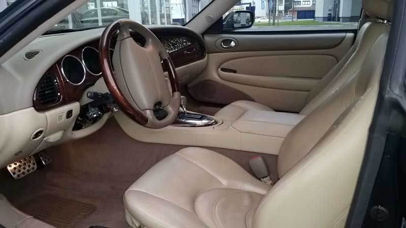

Hello Guys,
the search does not give any results for my question.
Mein XKR Model 2004 has the Trimcodes:
HGZ/SDZX
So, the leathercode must be SDZ ... cashmere ... but:
the stearing wheel and the dashboard does have a darker colour, so ... where can ich find a list or overview of the second colour ... cashmere must be the colour of the seats ...
i´m asking, cause i have to fix a hole in the leather and my leather-dealer asked about the colour.
best regards
danny

See pages 9 and 10 here http://www.jagrepair.com/images/Auto...0Parts%202.pdf
Cashmere is paired with Sable (AEK)

Also you will find there is very little actual leather in the car. I think the door inserts and the seat inserts may be the only leather, but not sure. There's a thread on this somewhere.

I can assure you the seats and backs are leather, with the exception of the side panels, as is the center console cover. I replaced mine recently is how I know.

I can say that the door inserts are most definitely not leather.
