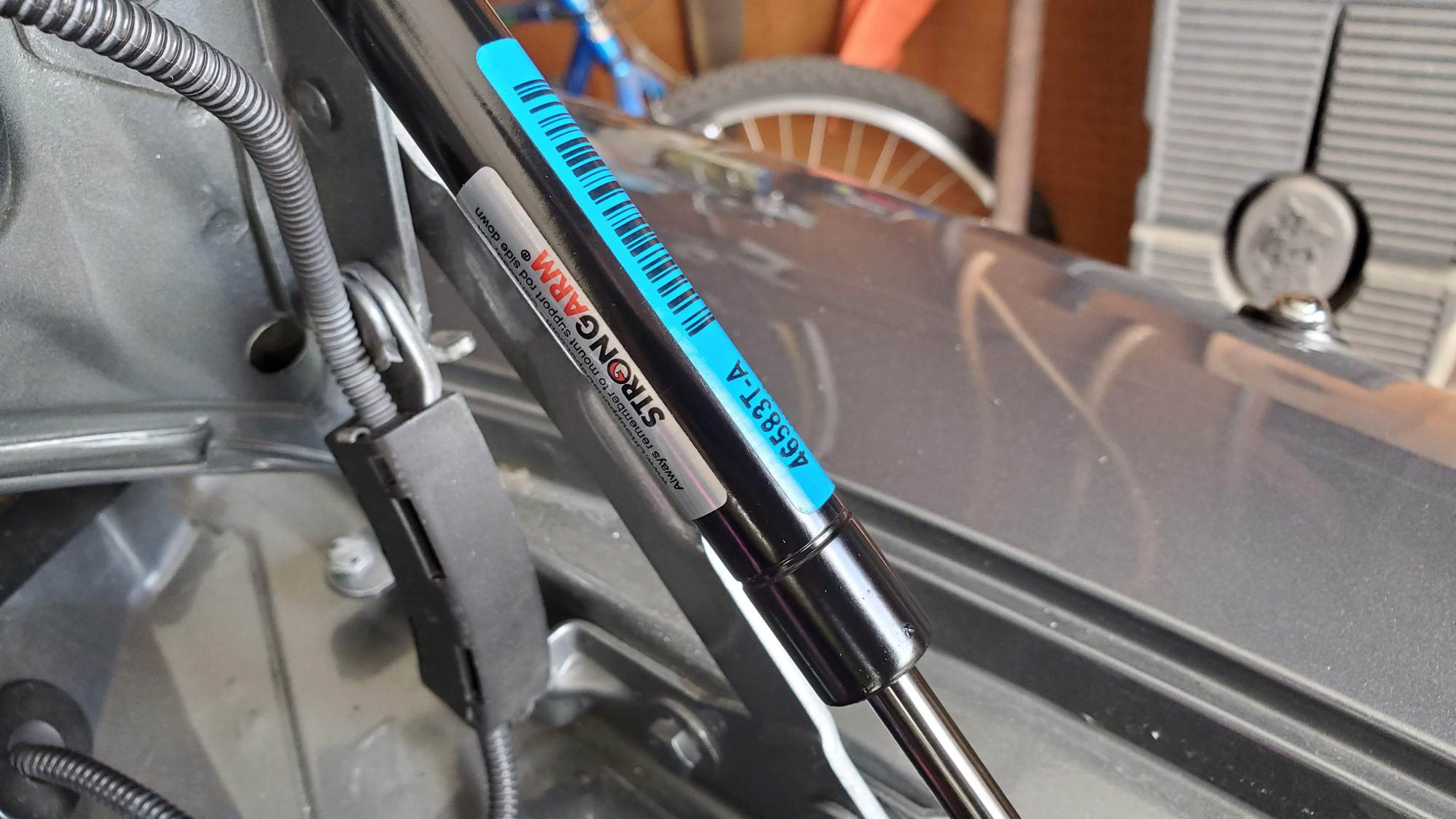

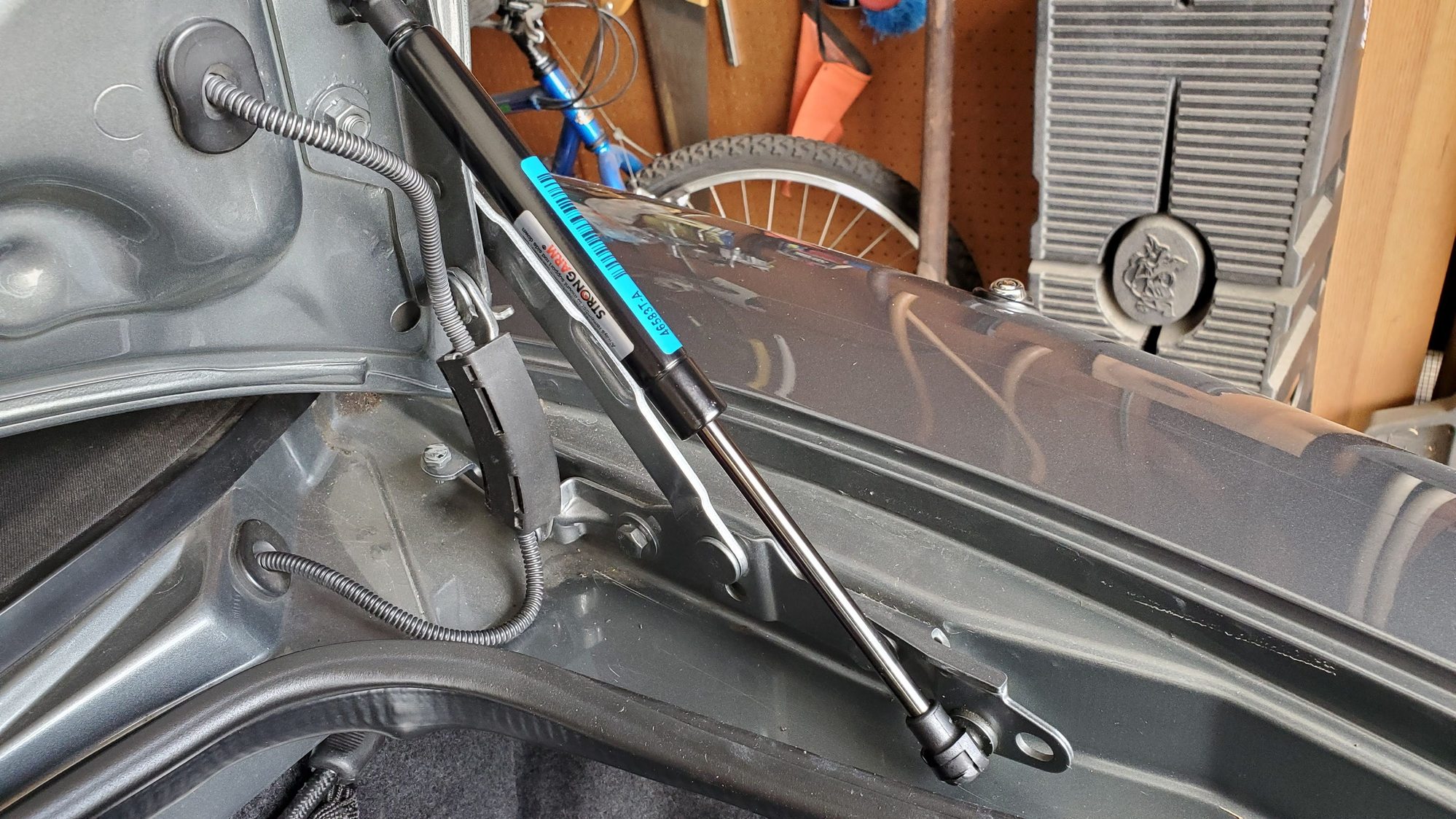

Old Apr 16, 2022 | 12:46 PM
SeismicGuy's Avatar
Joined: Aug 2007
Posts: 3,431
Likes: 573
Well I finally got around to replacing those boot struts and have some observations that might be helpful. First and most important is to make sure whatever struts you buy are the correct length. When googling several sources for these there were instances where even though it said the struts were for my year XKR, they wouldn't have worked since the overall length was incorrect. Seems that the length for the coupes was different than for the convertible. I also knew the original Stabilus number and sometimes found correct equivalents and sometimes not. If you have a convertible the length from ball stud to ball stud should be 11.5" and overall length of strut is about 11.75" so that is the key. I ended up ordering from LiftSupportsDepot and wanted StrongArm based on the recommendation from Jon89. What comes up for the trunk are models 6584 and 6583--the ones I ordered were 6583 and these are the correct equivalents to the Stabilus ones that were originally on the vehicle.
Removing the old struts are a bit of a PITA, especially the top connection. Easiest thing is to stick a small blade screwdriver to pop the metal retaining band from around the plastic end. Once that is done you can wiggle out the top connection. Same process for the bottom one but a bit easier. Then fairly easy to pop on the replacement struts. Bottom one goes on first then the top one. The top is a bit fiddly due to clearance but it will eventually pop right on without needing to do any filing or reshaping of the plastic housing.
The new struts work great and now the boot doesn't accidentally close on my head anymore. The interesting thing is that when I push on the old Stabilus struts to see how bad they were, one of them is a solid as a rock--I really have to lean in on it with my full weight to get it to compress so it is essentially like new. But the other strut clearly bit the dust since it not take all that much effort to compress it.
Well that is the end of the story. Hope it helps.
