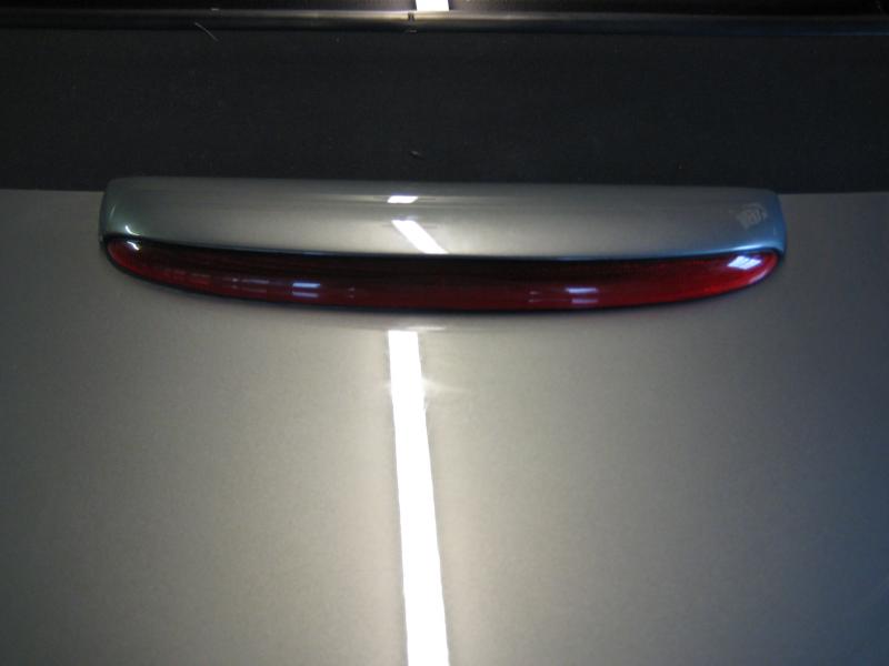

For 2+ years I have been putting up with my eyesore Sirius magnetic mount antenna (pics attached to explain), and I wanted to explore the possibility of hiding it under the third brakelight cover . Early on, I discovered that the brakelight cover was loose on the drivers side (broken plastic tab) and in trying to get inside to find out what was going, I removed the 3 black plastic stud cover disks and discovered that two of the three mounting studs/nuts were rusted beyond undoing.

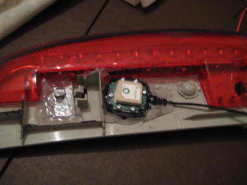

At this point, I now have 3 separate problems. First, some way to attach the cover so that it remains removable. Second, a way to replace the studs so that they will not spin around or move up or down. (you can see how the remaining factory center stud was plastic welded in one photo) And third, my quest to hide the antenna.
Here are my fixes: (I do not claim they are the best fixes but they did work for me)
First, the cover tabs upper traverse portion remained so that I could put holes (toward the rear for strength) in them to “screw” expansion springs one turn or so both toward the center of the cover. Then for spring clearance, I removed the back half of the mating locking tabs (up to the gusset) on the white plastic base. I did this so that a loop of dental floss could be attached to the other end of the spring and “fished” out the bottom of the base on both sides. (yes, if one of the loops come off, you have to start over fishing) . Once the spring is fished out the bottom, retain it at about the proper tension using a piece of shim stock slit with a hacksaw and sanded to width just wider than the spring wire. Clip excess spring and rotate shim till only one turn of spring is showing.
Second, I fashioned and hot glued stud plates as the pics show. (Credit to my friend for the TIG tack welding)
Last, I could not hide the ant. without taking it out of its case (backplate is screwed on). I killed the original ant. with a slip of a drill. I whittled out the location and hot glued the antenna in, then coated it with hot glue.
I was concerned about the metallic paint affecting the signal but so far, it does not seem to be a factor and I like the stealth look.
