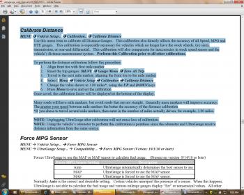

The UltraGauge User Manual spells out exactly how to calibrate the UltraGauge to reflect accurate speed, distance traveled and mpg. It's on page 31 and looks to be a very straightforward method. It is designed to work regardless of your wheel/tire size so you can get extremely accurate data. Here's a screen shot.
