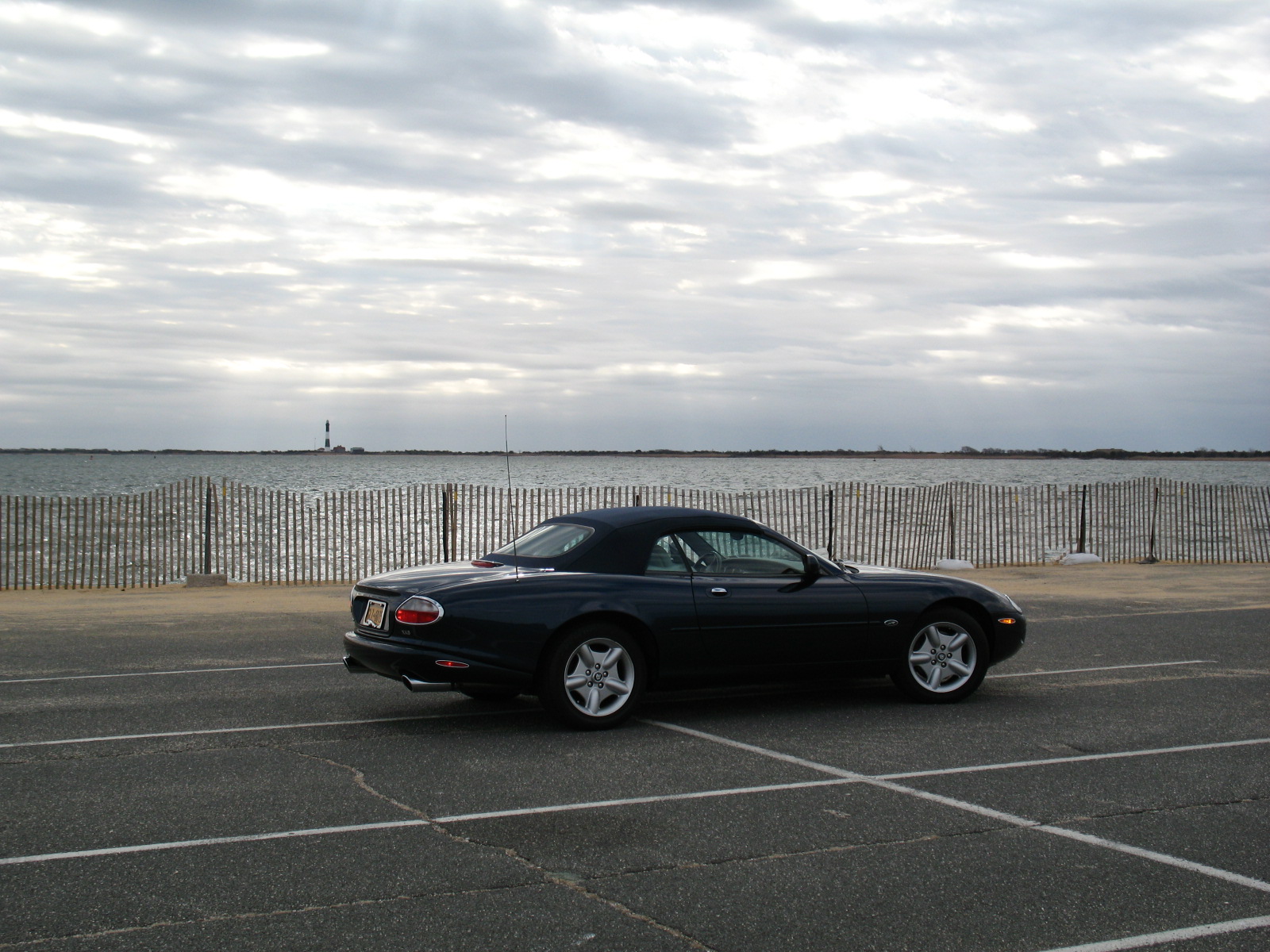

Did not work on my car today. Did take a nice 6:30am Drive to Captree/ Long Island- NY. Car show. Plenty windy with 35 degree temp. Plenty of die hards showed up for the car meet regardless of the weather. Including motorcycles and one brave heart in shorts.
View is one of our many light houses seen from Captree.
In addition you can see front ride height with my new Welsh UPGRADED upper spring/shock bushings replaced. These upgraded bushings are made with a very hard, plastic type material in place of the soft spongier factory bushings. Does make the car ride a little harder, lifts the front end and handles much better. tight curves the front end is flat. So consider you choices before you installed. Rich
PS, My XK8 only has 55k miles. Front upper shock mounts are a time issue rather than miles... Rich
