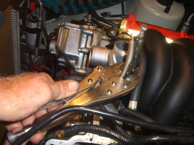

Do not remove the hood. There is an 90' upright setting. Pull the two struts from their sockets and manually raise the hood until it is perpendicular to the car. You will observe two holes in the forward hinges line up. Have a short 10 mm bolt ready to insert as they match up. This will secure your hood in an upright position for work on the front of the engine.
A couple of tips: Cut out a peiece of cardboard and place it in front of the radiator to protect the fins.
Also you will discover the two rear hold down bolts on the t-stat housing are difficult to reach. Buy a cheap 8 mm box wrench. Heat and bend it 90" and use vice grips to turn it. The front two bolts may be accessed using a ¼” drive and swivel; but the rear two bolts have limited access.
Use Vice Grips
The bent-wrench should be used in conjunction with a needle nose vice grip, and another regular style vice grip twisting the first.
The box head end provides for a tight and secure grip on the 8mm bolts. Using the vice Grips, there is plenty of torque available to tighten the housing base down without fear of stripping the bolts or scraping your knuckles. Forget about the ground down sockets... this is the tool to use.
Shorter Bolts in Two Rear Holes
When replacing the new aluminum housing, use the old 8mm bolts that attach the T-Stat cover to the OEM plastic housing. They are a little shorter which allows for them to be inserted easier. I used needle nose pliers to first insert them in the rear holes.
Grind Screwdriver Slots in the Rear Bolts
It is simply too tight in there for you to get anything more than the tip of a finger on these bolts. Use a dremel or similar tool to cut cross slots in the heads of the two rear bolts. These slots will allow a screwdriver to turn down the bolts until they become snug. A screwdriver makes it easy. Then use the bent-wrench for final tightening.
Attached Thumbnails water pump-thermostst housing?-bentwrench.assy%5B1%5D.jpg   water pump-thermostst housing?-bentwrench.jpg   water pump-thermostst housing?-bentwrench.vice.grips.jpg
