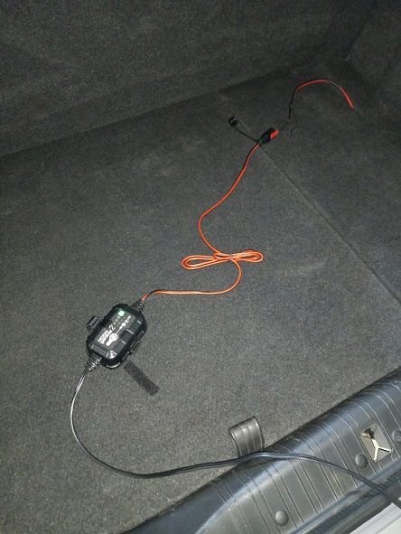

+1 for trickle charger/maintainer as an essential accessory for early XJ and XK cars. Don't understand why they are so vulnerable to voltage drop but even slight fluctuations due to parasitic drain can cause chaos. I've had good luck with a NOCO Genius 2 for the last 5 years, with QD pigtail permanently wired to battery.
