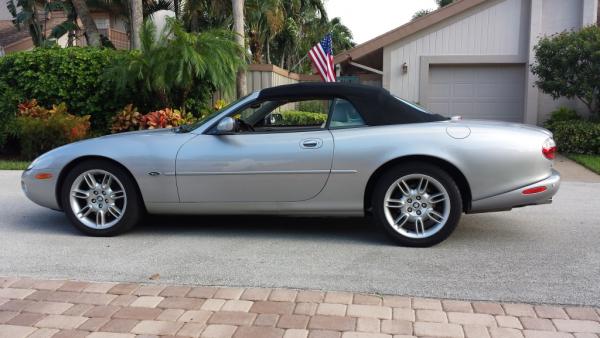

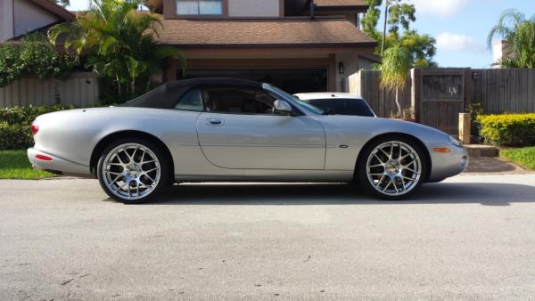

I upgraded my wheels from the 18" impellers to 20" after market wheels and I think the car rides BETTER (and the overall wheel diameter is roughly the same). Maybe it's the tires, but it rides smoother and corners better... AND it definitely looks better with the larger wheels.
So I say GO FOR THE 19" WHEELS!
Before:
After:
Attached Thumbnails What Would You Do?-blindside-119887-albums-my-jag-7802-picture-before-19912.jpg   What Would You Do?-blindside-119887-albums-my-jag-7802-picture-after-19913.jpg
