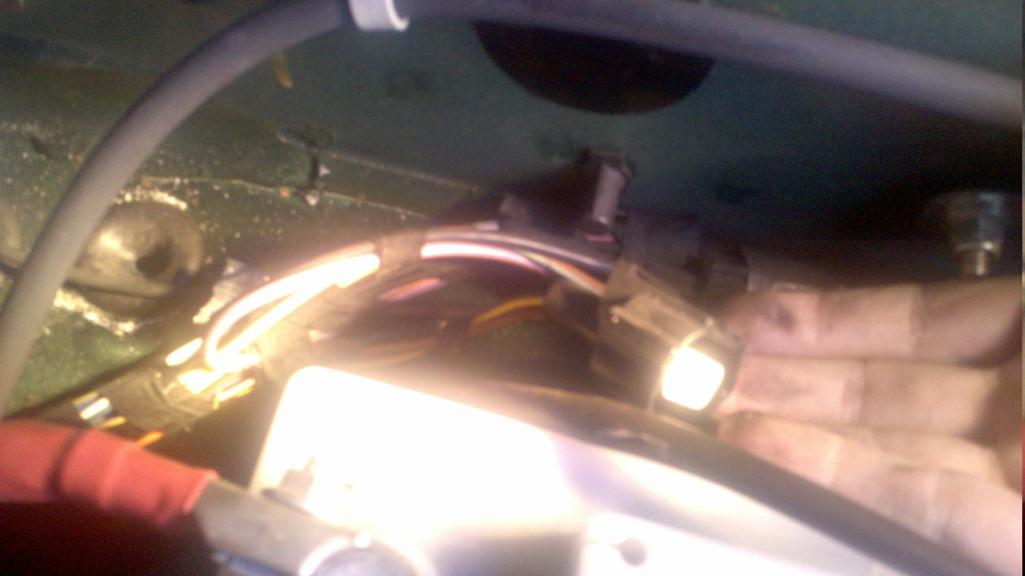

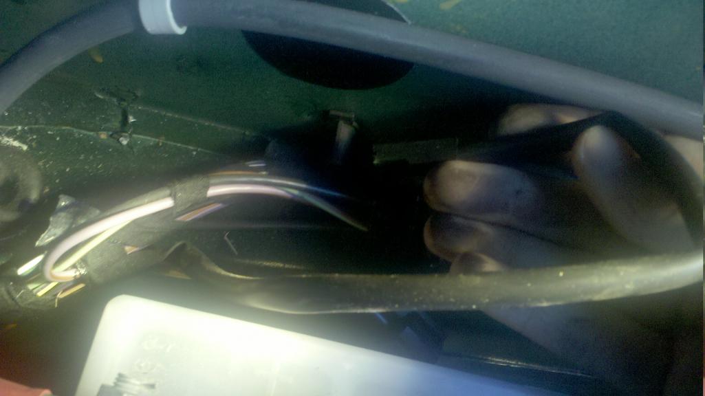

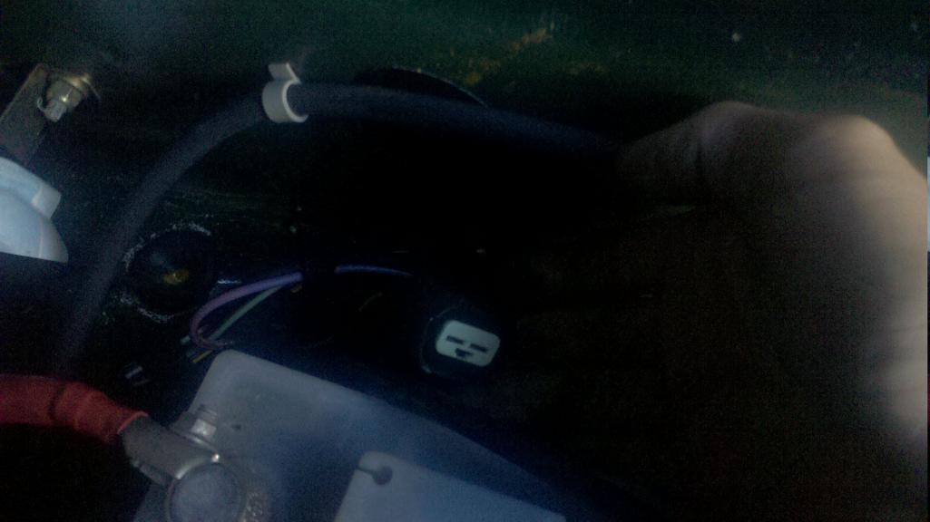

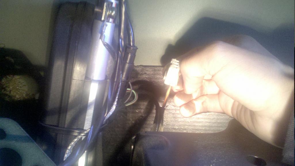

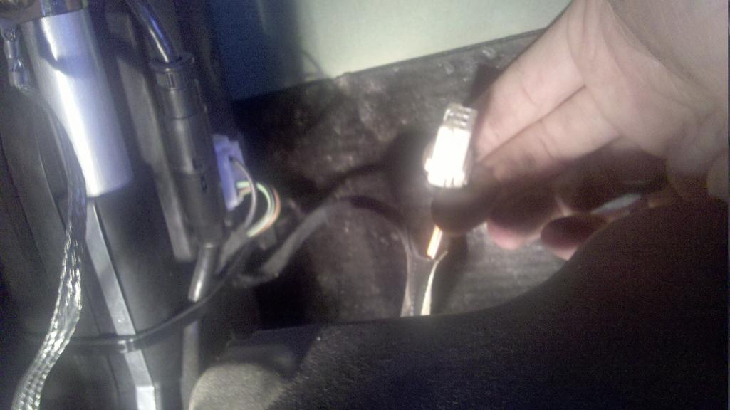

As Lew has pointed out and I've turned a blind eye to, my mast seems to be permanently erect. Now that it's nice out and I have some time on my hands, I figured I'd take the back apart to find out what's going on here. I've found some empty plugs and I hope that these are the cause.
Pictures 1 and 2 are the same thing. Light blue, yellow/orange and pink/black.
Pictures 3 and 4 as well. These wires are yellow and brown
Picture 5 is a plastic tube thing with only one wire in it.

Those are connectors for options your car doesn't have, and for the battery transit device that disconnects the battery for the trip across the pond to your dealer. Step away.
You don't say whether the antenna runs at all. If it does and mast still won't go down, it is most likely corroded sections. Sometime the mast can be removed and lubricated, but the usual fix is a new mast.

Buy a new mast and forget about the old one. The tube thing ? Might that be the breather that should hook up to the battery?
