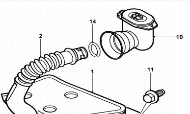

Dear Jaguar enthusiasts,
I'm trying to remove the ABS controller on my 2001 XK8 convertible, but the windshield reservoir nozzle-fill point in the way. Any idea how to remove that?

HI.
If you tilt/swivel the filler neck (10) forward about 90 degrees, you should be able to remove it.

Hi Oyster,
By forward, do you mean towards the engine, the exterior or the front of the car.

Towards the front of the car.

Thank you Oyster. It worked
