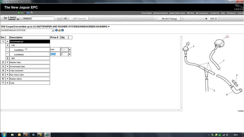

Old Feb 10, 2012 | 12:23 PM
Originally Posted by Don Keyser
So, I'm just out of luck then? Cos all I'm getting are streams not a good spray. I looked at the post you suggested but, didn't find any info that would help me with my problem. So, would I need to buy the whole wiper arm to get the new sprayer? If so, where can I buy that without giving up my first born child? lol
I knew they weren't available separately in the UK from the last time I needed one but have found them listed separately for the early cars in the US parts manual:
Still a lot of $$$$ and not much short of the cost of the complete arm.
Over here, I'd be going to a specialist Jaguar breakers. Similar source (if available in the US) is likely to be the way to save the first born.
