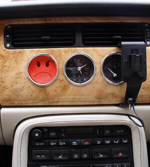

While you're waiting for delivery of your Realgauge to resolve the issue, you could use this temporary fix:

A Jaguar for millennials!
