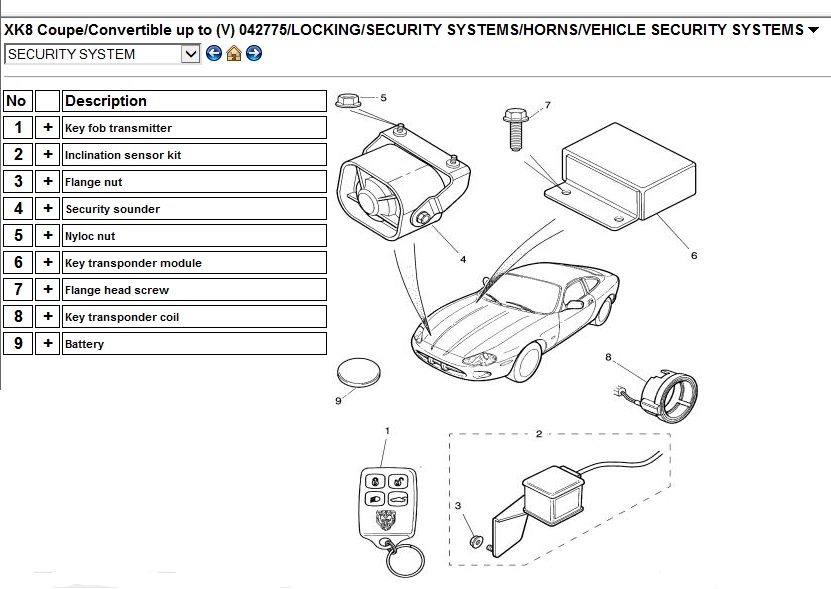

Any chance you accidentally unplugged or dislodged the key transponder coil that is around the ignition barrel? Number 8 in this image:-

That is very likely. Is that the white plug I mentioned adjacent to the valet switch that is just dangling and not connected? I thought it was a plug to fit into an adaptive cruise control switch? I’ll have another look under dash around ignition switch.
Many thanks and will report back!
