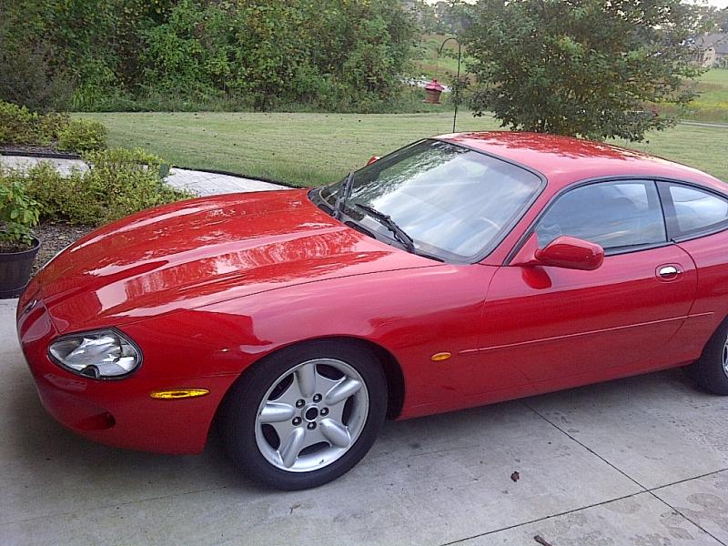

Purrrrrrr…..
Got the Jag back yesterday afternoon, purrs like a kitten, can barely hear it run at idle, no warning lights, no oil pressure issues.
New (used-low mile) engine installed, all new seals from front to back of engine, all new timing components, new motor mounts, most new cooling hoses, upgraded t-stat housing, synthetic oil, coolant flush. I have never heard this car this quiet and this smooth. Thank you very much to V-12 Motorsports, I am riding in style again! Should be sitting pretty for at least the next 12 mos since the work (parts and labor) is warranteed.
It has been a long road, but I am finally getting to enjoy the car again, after all my struggles, it was worth it. I look forward to more carefree driving past its 160,000 mile mark.
Thanks to everyone for their help, assistance, support, and encouragement during this difficult time!

Congratulations...glad you're back on the road. The car looks great.
What did you do with the old engine?

Yes, love it. I had the car painted a few months before the engine troubles, so I haven't been able to drive it much with the new red color. I am now getting to make up for lost time.
The salvage yard wanted the old engine w/heads back or would have charged a core of $500, so I let them have it back. Maybe it will be brought back to life in the future.

Good news MR CJ, and the red is looking good too.
Any plans for the amber lenses?

Yes, the amber turn signal lenses were plugged into the existing plug-in connector behind the fenders. They work as turn signals now with no modification, truly plug-n-play!
