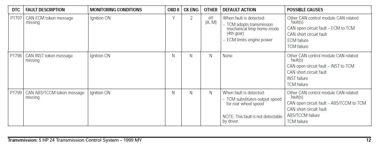

The codes are transmission related and fortunately have similar possible causes across the years. Here's the Jaguar decode for 1999MY:
The "sounds like it was only running on four cylinders" is indicative of transmission limp home mode.
An Independent is going to be expensive to troubleshoot and fix this. A dealer, even if they would touch a model that's been out of production for sixteen years, would be astronomical in labour charges alone and probably get nowhere.

Taking all of these in toto, from a diagnostic standpoint, it seems unlikely that the ECM, ABS, and INST failed at the same time unless the engine was hit by lightning. Even then...
So that leaves TCM failure, and/or some issue with CAN bus connectivity. With these three codes, the possible CAN issues all point at the TCM or a general short in the bus, but presumably a general short and/or TCM failure would also report TCM token missing.
Inexplicably, the TCM token is not missing, suggesting it's the battery as noted above by Graham and as being addressed by y'all.

From those codes, it looks like your CAN bus is not operational. There is some form of resilience built into the design of these data buses, but CAN needs 2 termination (at 120 Ohms). The 2 "end" devices are the ABS module and the Instrument Cluster I believe. From memory, the early cars have that failed solder spot in the IC that is well documented and fixable with basic soldering skills. Check the TSBs on Jagrepair.com for more details. This is not a difficult/expensive repair.
Otherwise, you need to find someone that is willing to diagnose that CAN bus. I think the basics are simple (resistance of 60 Ohms to ground to check at the diagnostics port), but then you have to go around and disconnect the other CAN modules one at a time for further analysis. On an early car, the ABS module shortcoming are well documented and would be the second best bet.

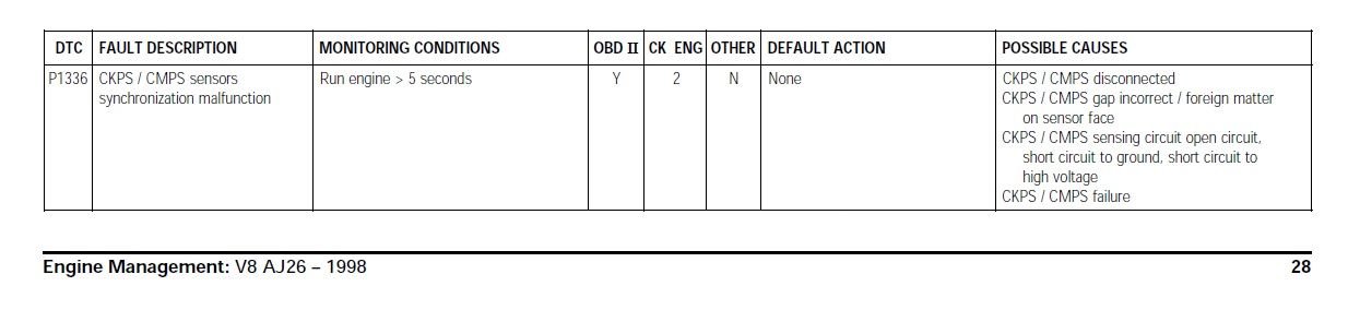

Why do people lie about things? The garage my wife originally took the car to said problem was codes 1797 1798 1799. It became obvious after a few days he clearly didn't want the job, said he doesn't care about customers any more as he is retiring in a months time. It is for this reason she took car away on a tow truck to bring it home.
Yesterday my wife fitted a new battery and car behaves the same. A friend who has OBD reader hooked it up and has code P1336. Cam shaft position sensor.

That's correct for P1336:

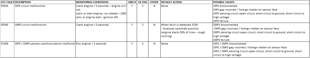

The car is complaining about the cam & crank sync, rather than a hard crank sensor fault (P0335) or cam position sensor fault (P0340)
You could try disconnecting one or the other to see if either makes any difference. There is some built-in intelligence, although I'm not sure if the car will even start without the crank sensor input.
What is the car's history re timing chains?

Was this the only code (i.e. no misfire codes or anything else)? The P1336 and lack of P0335 and P040 seems to indicate that both (CKP and CMP) are functioning, and the circuits are fine, but the ECM can't make sense of the measurements coming from the two sensors. So, the workshop manual suggests checking the sensors for debris (you could also do the sensor circuit tests for grins, but the car thinks they are okay?).
