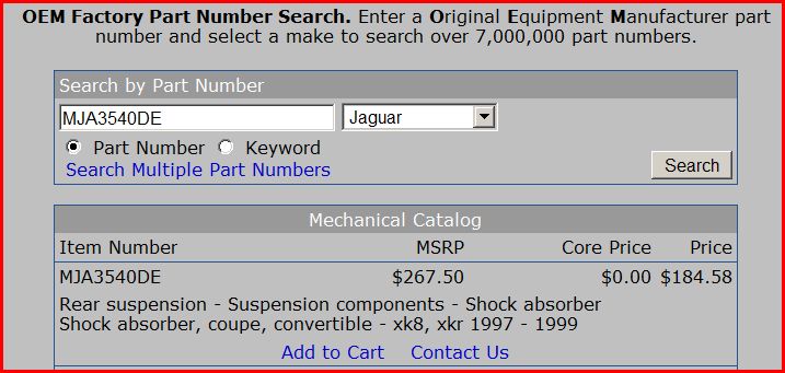

Originally Posted by Paul Pavlik
I have a Parts List that calls out Jaguar Part# MJA3540DE for the Standard (Non-Adaptive) Suspension.
This may be superseded by a newer#
Same part number:
Attached Thumbnails XK8 rear shocks/damper part number?-xk-rear-shock.jpg

The seller said the ones I have just bought were listed for XK8 non adaptive with a number MJA3540DC then when they arrive the number on them is MJA3541DC on the bottom of the damper!
They are genuine Jaguar as they have the leaping cat logo!
Old May 27, 2011 | 08:53 PM
hlgeorge's Avatar
Joined: Apr 2008
Posts: 3,472
Likes: 259
From: Atlanta, GA USA
That is strange! Part number MJA3540DC was superceeded by MJA3540DE. Part number MJA3541DC does not show up in the catalogues.

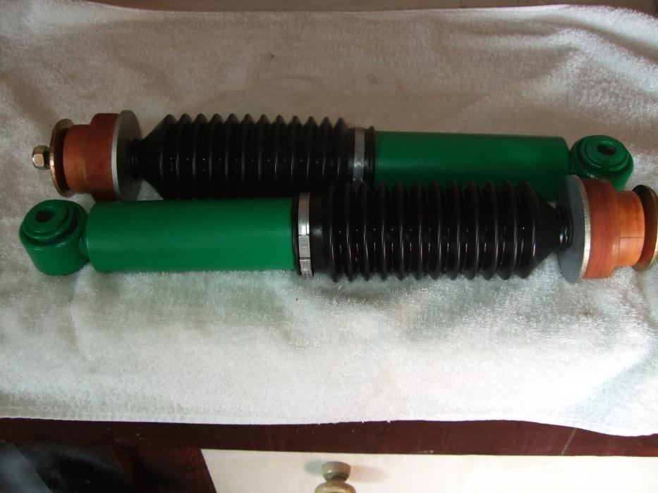

Default XK8 rear shocks/damper part number?
Are they your old ones? or the ones you bought. as they look used.
But they look like genuine Jaguar parts but if second hand too expensive IMHO
I have all of the these available All Powder coated
Regards
Bleasie
Attached Thumbnails XK8 rear shocks/damper part number?-mja3540de-damper-suspention.jpg   XK8 rear shocks/damper part number?-dscf2239.jpg   XK8 rear shocks/damper part number?-dscf2248.jpg

NOS means new old stock,so they aint brand new off the shelf and in the box!!!
If I thought that they were s/h I would of sent them back.
I am not into powdercoating to tart up how it looks,as done on the wrong component it will not last long anyway!

Hi Pilkie
Sorry just thought as the bolt holes were rusty they may have been used.
Did not powder coat the Dampers just the springs & cups which came new from Jaguar un painted ---and having left them out overnight to test Yes they had started to rust so for £10.00 they should last forever.
The coil springs are only painted when new so for another £15.00 I had them powder coated.
Coil springs have been on back order for over 12 months & no sign of them being re produced,
Regards
Bleasie
