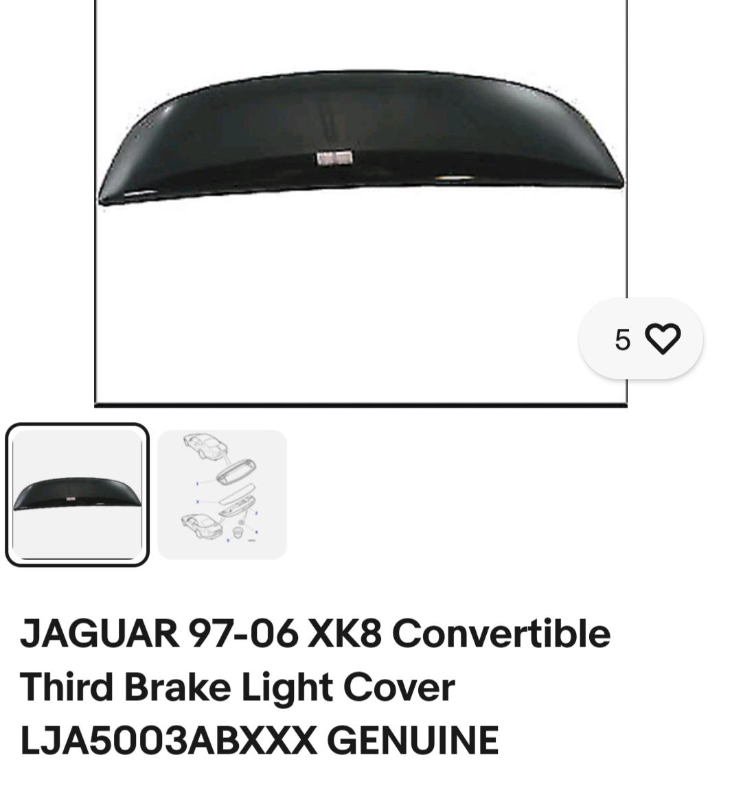

Hello: I've noticed that the thin plastic cover for the trunk-mounted third brake light cover is missing on a number of convertible XK8s as well as mine. The cost of a replacement on EBay is ridiculous, ranging from $118 to $197.

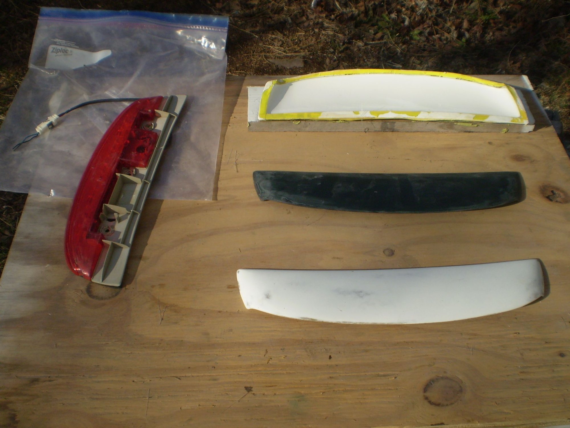

OK I dug mine out & it is definitely something I can make in fiberglass. I'll be making a scoop in the next few days so I'll pull a mold off of the brake light cover at the same time. I'll keep you (y'all) updated on the progress.

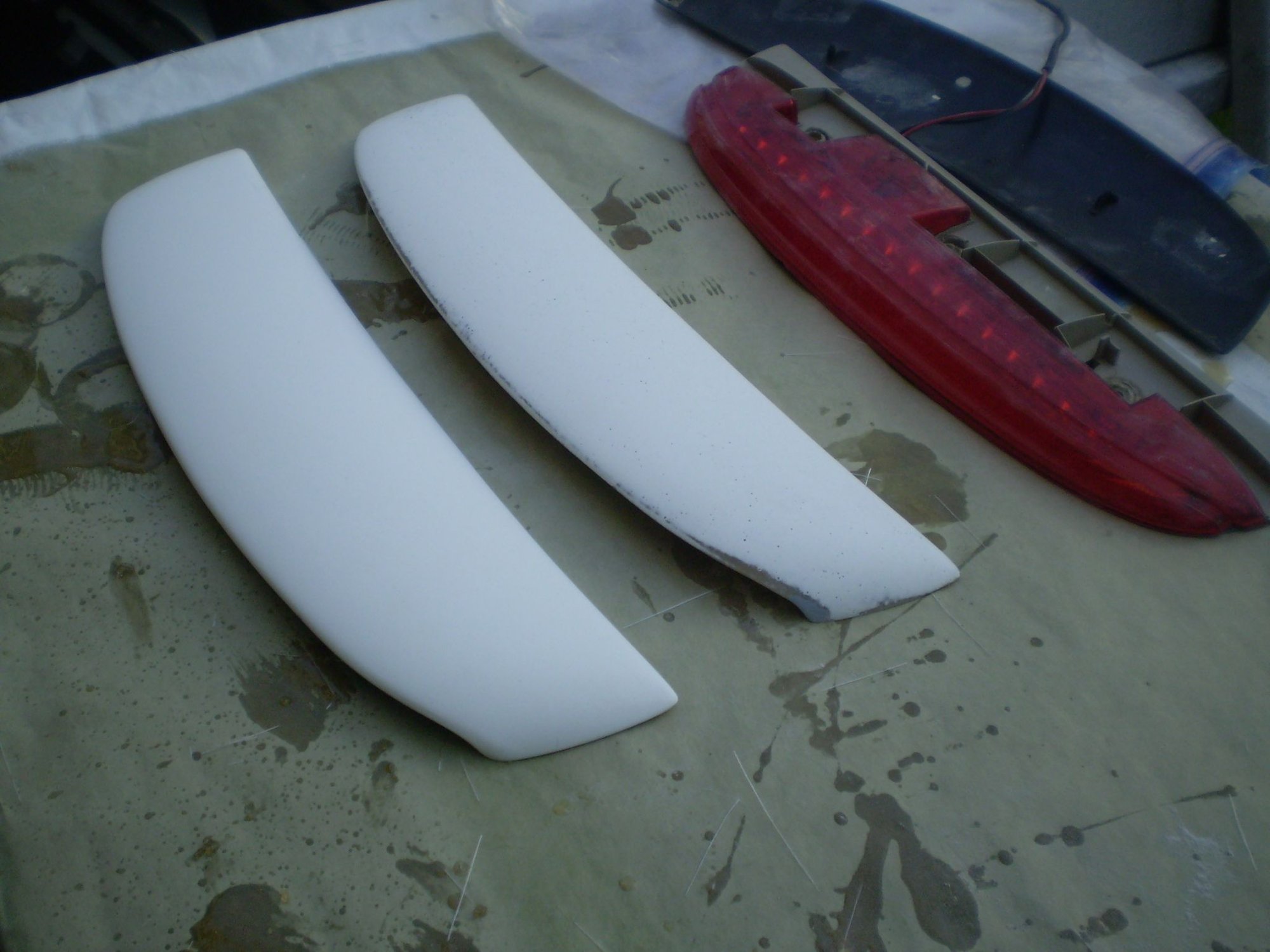

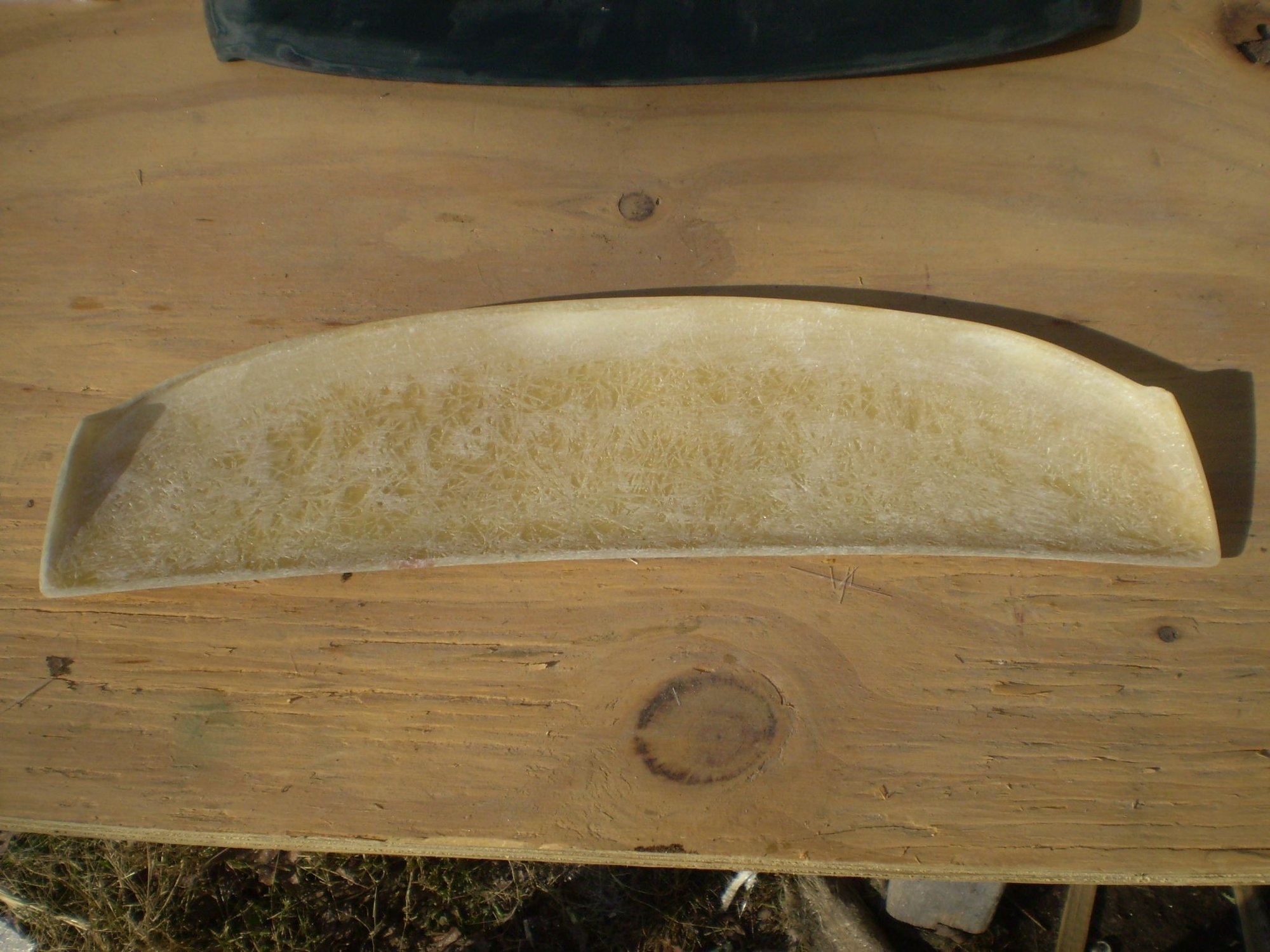

Ok so I got the first part out of the mold. The mold release left a texture (I think it froze before drying - it's water based) in the gelcoat so I sanded it smooth & that made the gelcoat a little thin. It doesn't hurt the part, though.

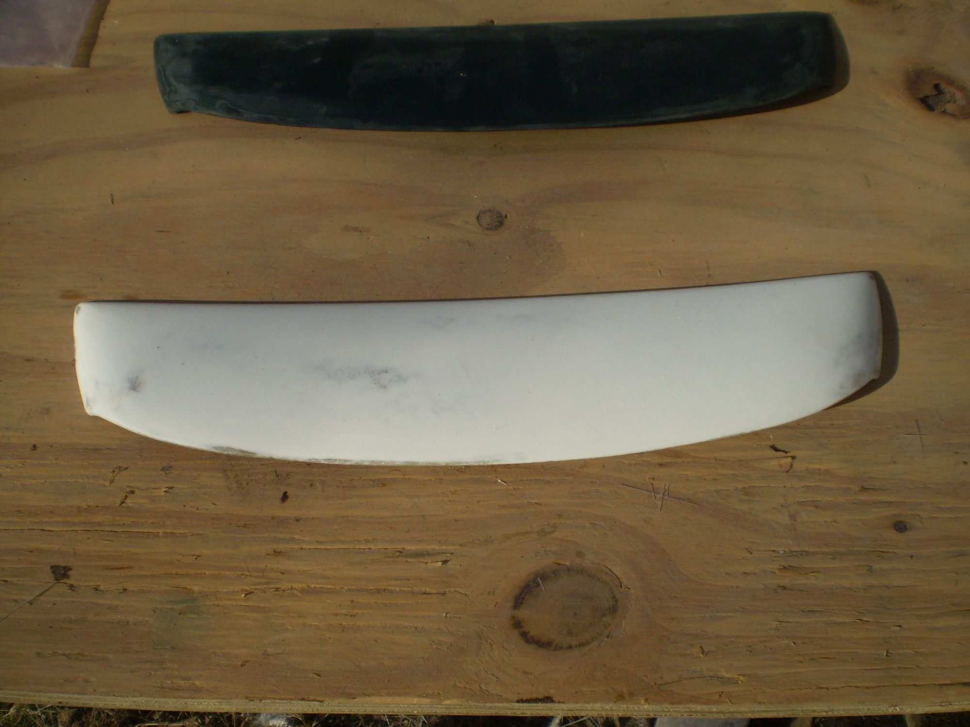

At first I was disappointed in the fit: it didn't go all the way to the bottom on the sides close to the red lens. It was about a 16th of an inch short. Then I tried the original cover & it fit exactly the same.
I would like to re-design the part to cover the red lens more - covering the indention that the black strip goes in, but I don't know when I'll have time to do that. I think it would make a better looking part, though.
If anyone wants one you can have the one that's made now for $45 shipped in the continental U.S., &/or I'll be making more for the same price as I make other parts.
These are gelcoated fiberglass & will need to be primed before painting. I think 3M double-sided molding tape is probably the best way to attach it, but a good glue should work fine too.

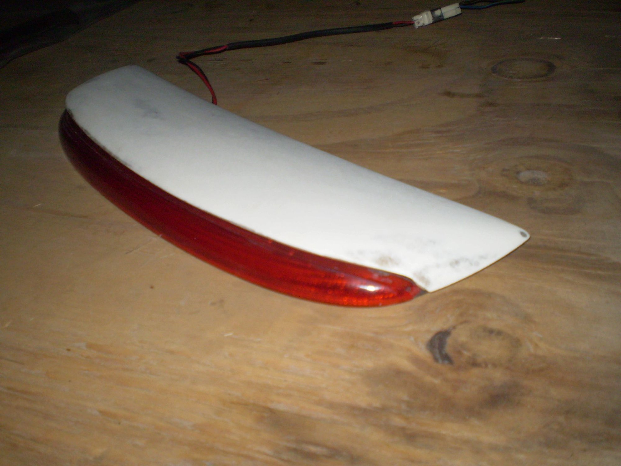

Do you have a photo of the cover on top of the light fixture?
Thanks,
Larry

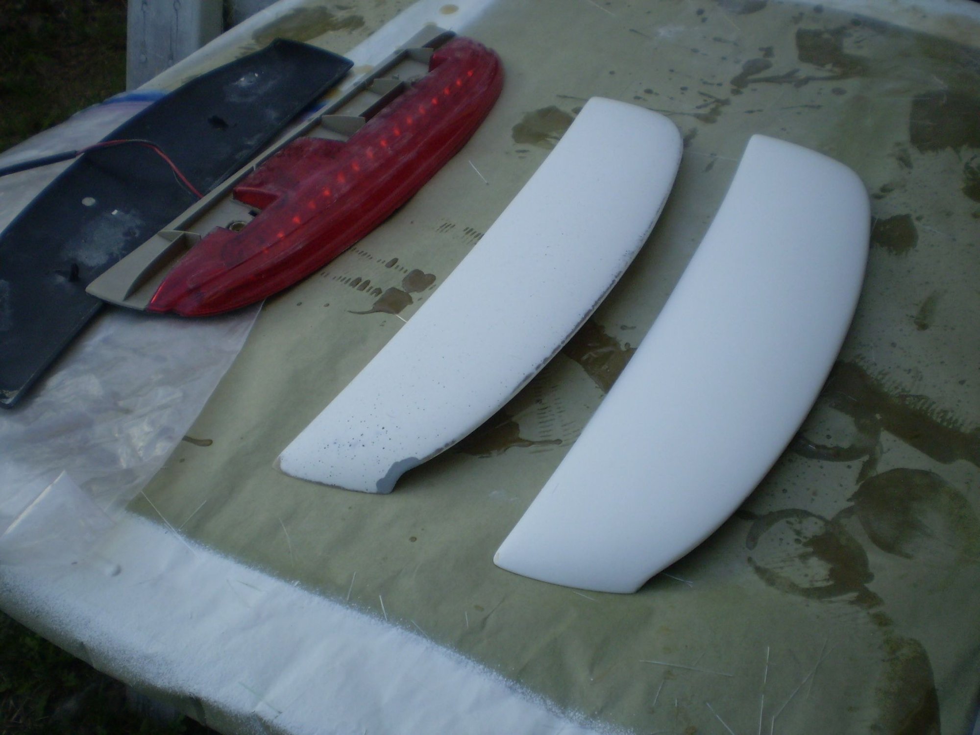

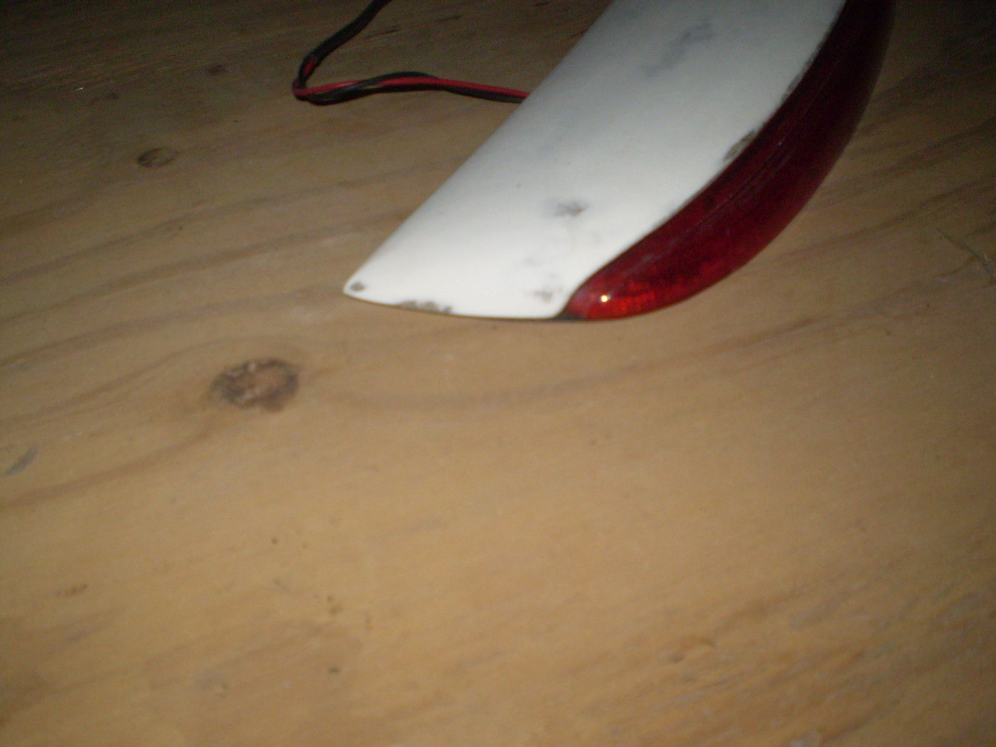

Took some in the daylight but they were blurry. So here's a couple with the flash.

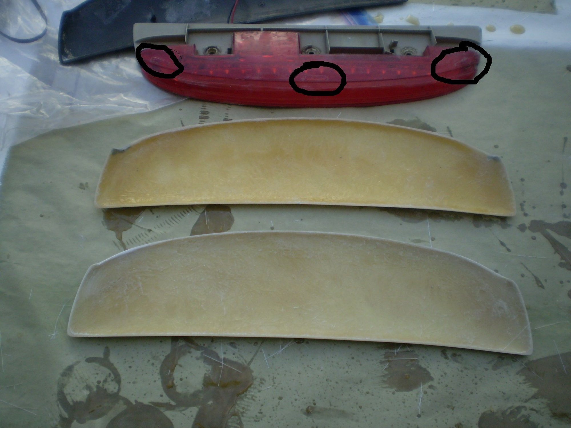

Made a couple more...
There is a guy that messaged me on Feb. 17 & I didn't get an email about the message so I didn't notice it right away, but I've messaged him back & he will get first dibs on one of them. Yes I have the settings set to email me: i don't know why it didn't. Best to just email me if you want one. imthadriver@yahoo.com
Also, I think it best to grind down the three little tabs on the red lens for a better fit, even with the factry cover (circled in image).
