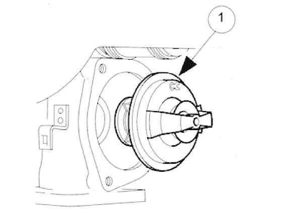

Old Sep 1, 2012 | 05:53 PM
Likes: 17,015
Did you fit the thermostat with the 'giggle pin' at the 12:00 o'clock position?
This allows any air to bleed. You can also speed up the process on a COLD engine by removing the Expansion Tank cap and repeatedly squeezing the top radiator hose.

Old Sep 1, 2012 | 06:20 PM
Bones28's Avatar
Joined: Aug 2012
Posts: 106
Likes: 30
From: Essex. UK
Yes it was at the top, maybe a bit of water pump blade has gotten trapped in the heater pipe if that can happen.
