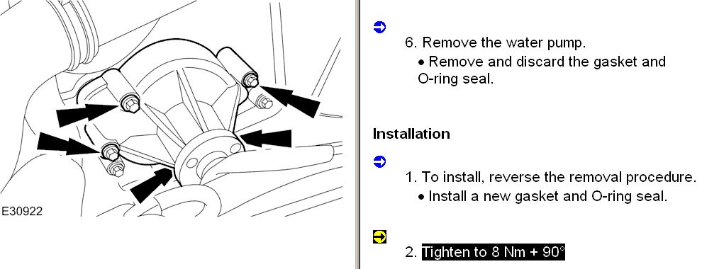

Remove the water pump and check the fins that spins the water,do this now, before the engine fails. Clean the old gasket off if necessary slowly using a copper penny or razor, apply a light coat of black rtv to prevent leaks.
