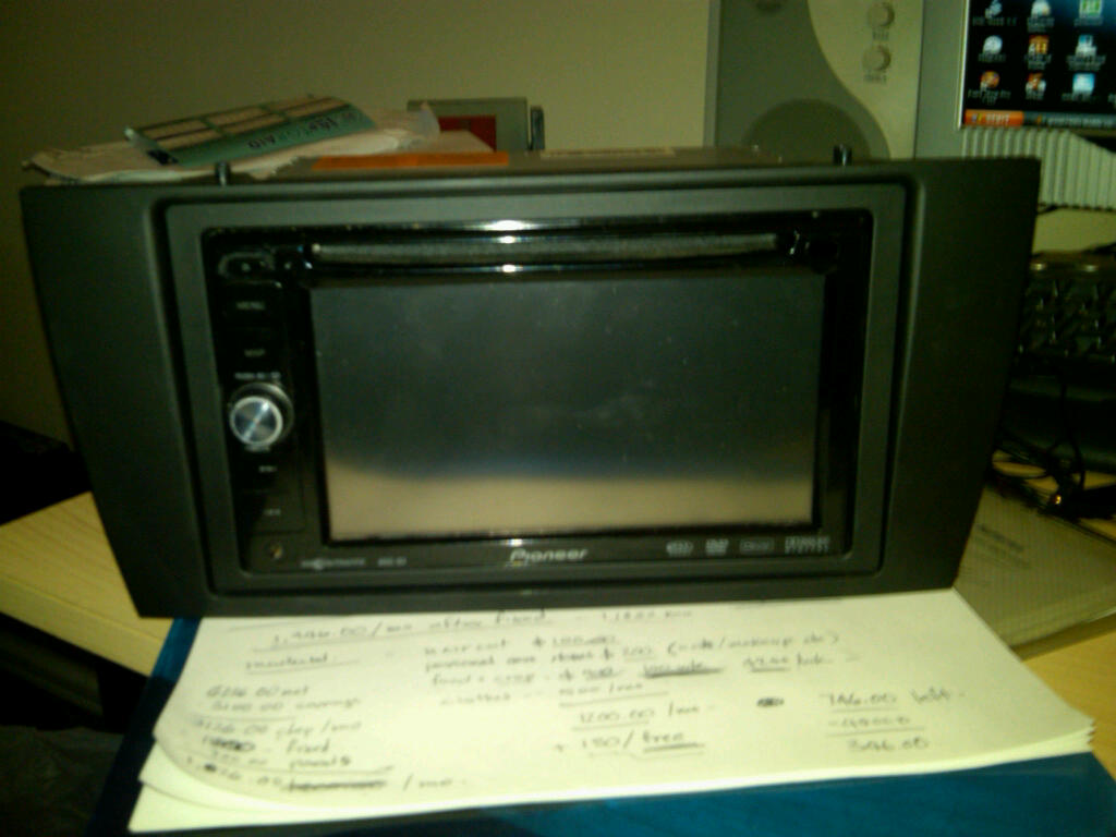

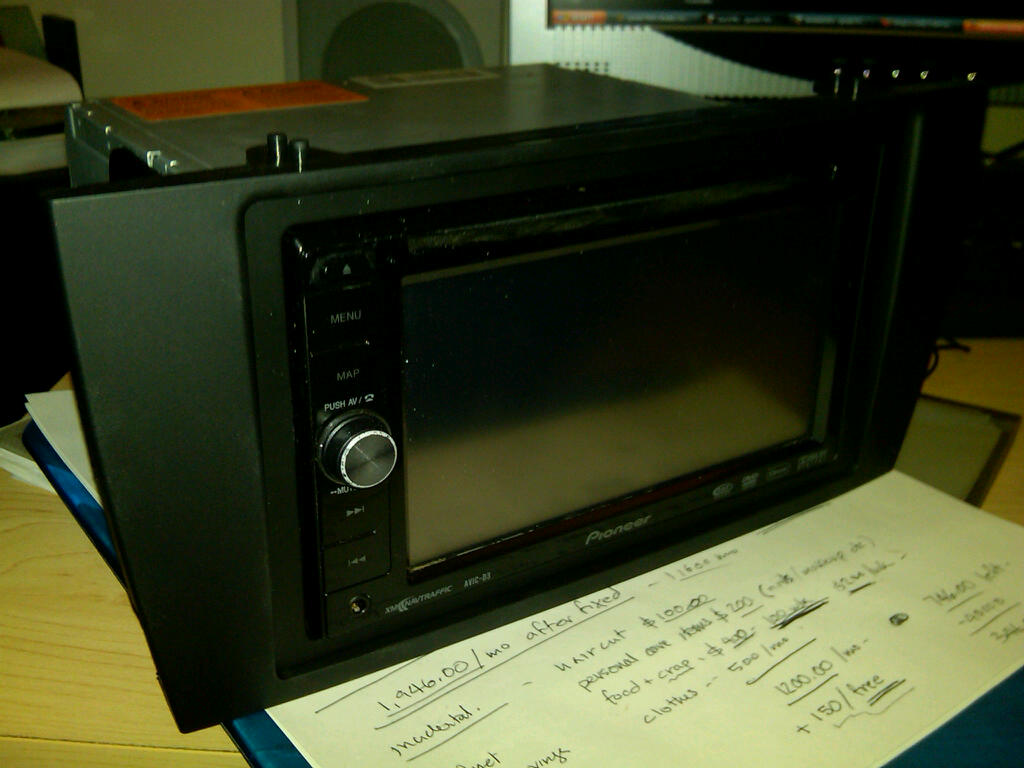

My initial impressions of the kit. Fit and finish seem to be fine, and it will match the dash better than any nexxia kit will. The brackets that hold the radio to the side of the kit seemed a bit flimsy in their attachment to the sides of the kit, but once the radio is in and it's all bolted together it seems tight. The trim ring is the slightest bit too big for the pioneer head unit, and it left a 1/16" gap between the ring and the headunit. I'm sure this will disappear once the radio is in the dash and there is no light source behind it. Overall I'm very pleased.. I'd give the kit an initial 8/10.
I took a couple (crappy) pics with my blackberry of the kit with the Avic D3 in it. That's as far as I have gotten so far because of the 20 or so degree temperatures in my garage this weekend. It's supposed to warm up a bit later this week, so hopefully I'll get a chance to put it all together fire up the camera and give an impression of what it really looks like in practice.

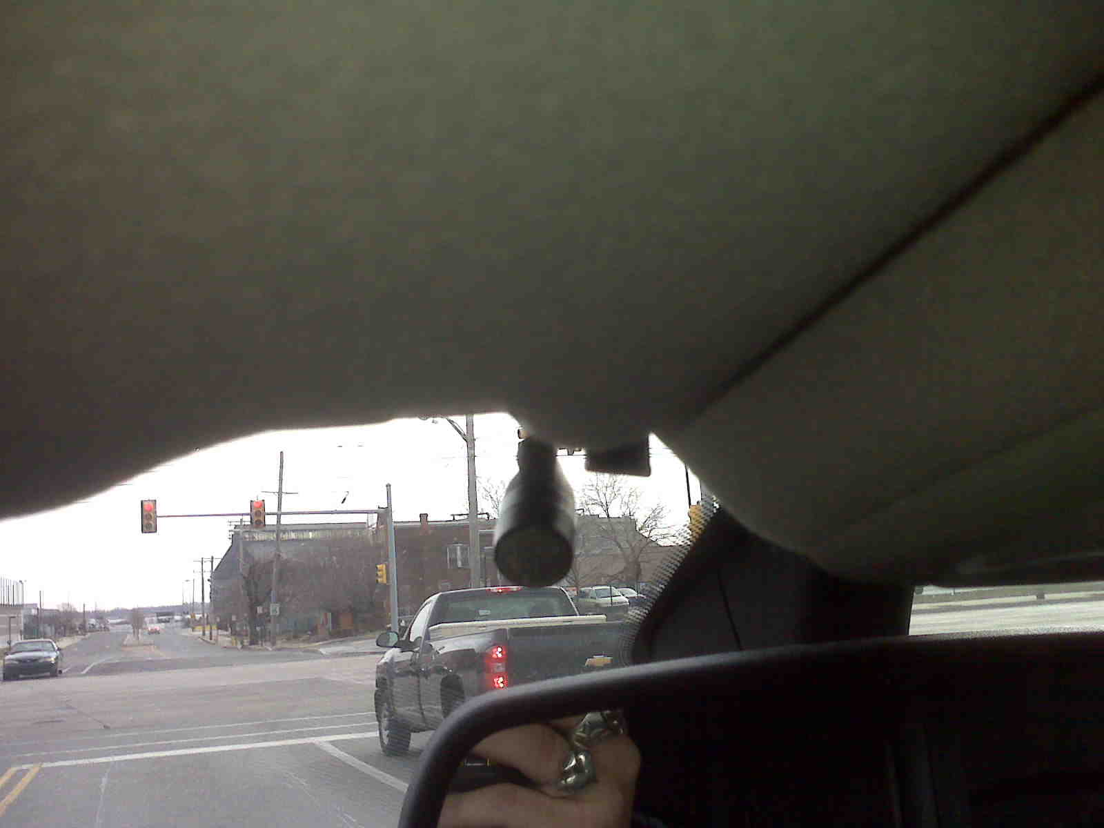

i have the alpine mic (ex-10) mounted directly to the left of the console on the roof aimed at my face. Seems to work well in that location for me. And the wire run was realllllly easy

I'm planning to place it the center console above climate control. There is opening (I'm guessing factory mic location). This would be simplier to wire. If the roof console location is better, I would go with that route (hope that the wire is long enough).
Jason where are you talking about - right near the ignition lock? Or somewhere else.
Old Jan 13, 2010 | 01:03 PM
  #36
phd12volt's Avatar
Joined: Jan 2009
Posts: 1,145
Likes: 55
From: PA
to the left of the mirror
Attached Thumbnails Aftermarket In-Dash Receiver/nav units-img00104.jpg
