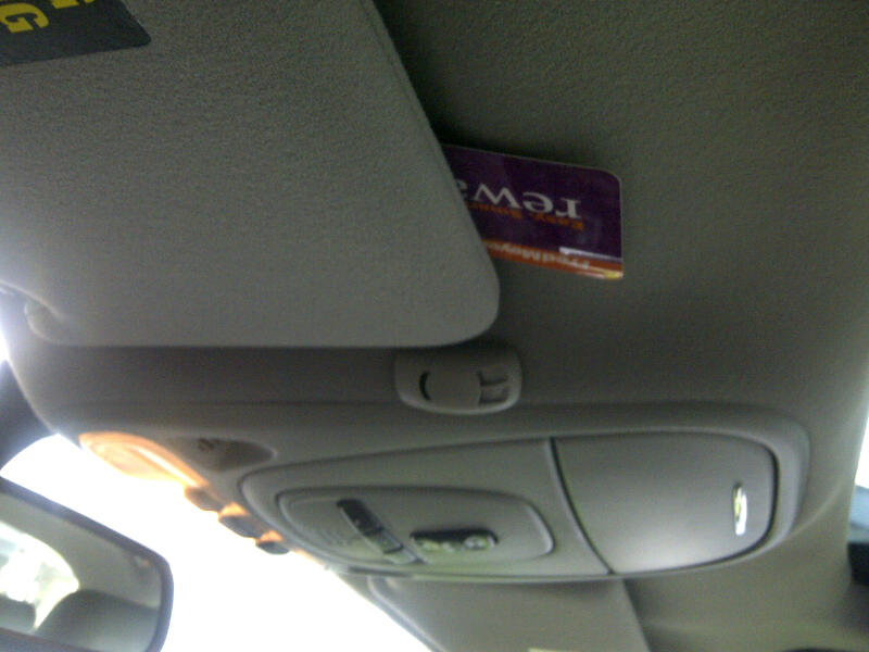

Is the Bluetooth mike this thing next to my upper console??...

Yes. That's it.
