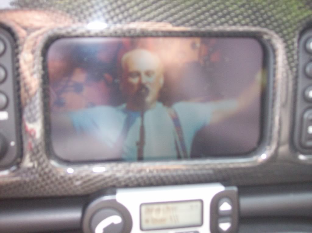

Is this what you are trying to do???

yes Ive seen several systems in customer cars. And all 3 had dvd players switched in through the video feed and audio through the audio
