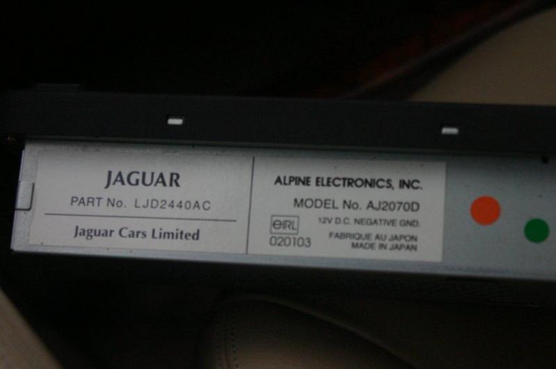

The facia panel removal vid helped allay my apprehension of messing up the dash, thanks. This morning is cool and I did not run the car, simply got the electronics going and tried to recreate the failure mode before I started, no luck, everything was nominal. But, proceeded to remove the nav unit anyway. Unplugged the 2 connectors, they don't look particularly shiney on the contact areas but I don't have any contact cleaner yet. So I put everything back together and will test again once the sun comes out and I can heat soak it a bit.

Well it could also be the connector on the nav unit in the trunk also, but at this point my guess is you have a bad solder joint or intermittent component in the display unit.
A couple of thing you might consider:
-You can find these displays used on ebay usually around $150-$200. Buy one that has a full return policy so if it turns out not to be the problem, you are just out the return postage.
-Ask a moderator to move this post to the XK8 section, and ask if anyone has a spare display to loan, for perhaps a deposit. I have quite a number of customers who have replaced thair nav. units with the 3-gauges using my harness. (The forum discourages reposting, that is why it is best to have the post moved).
