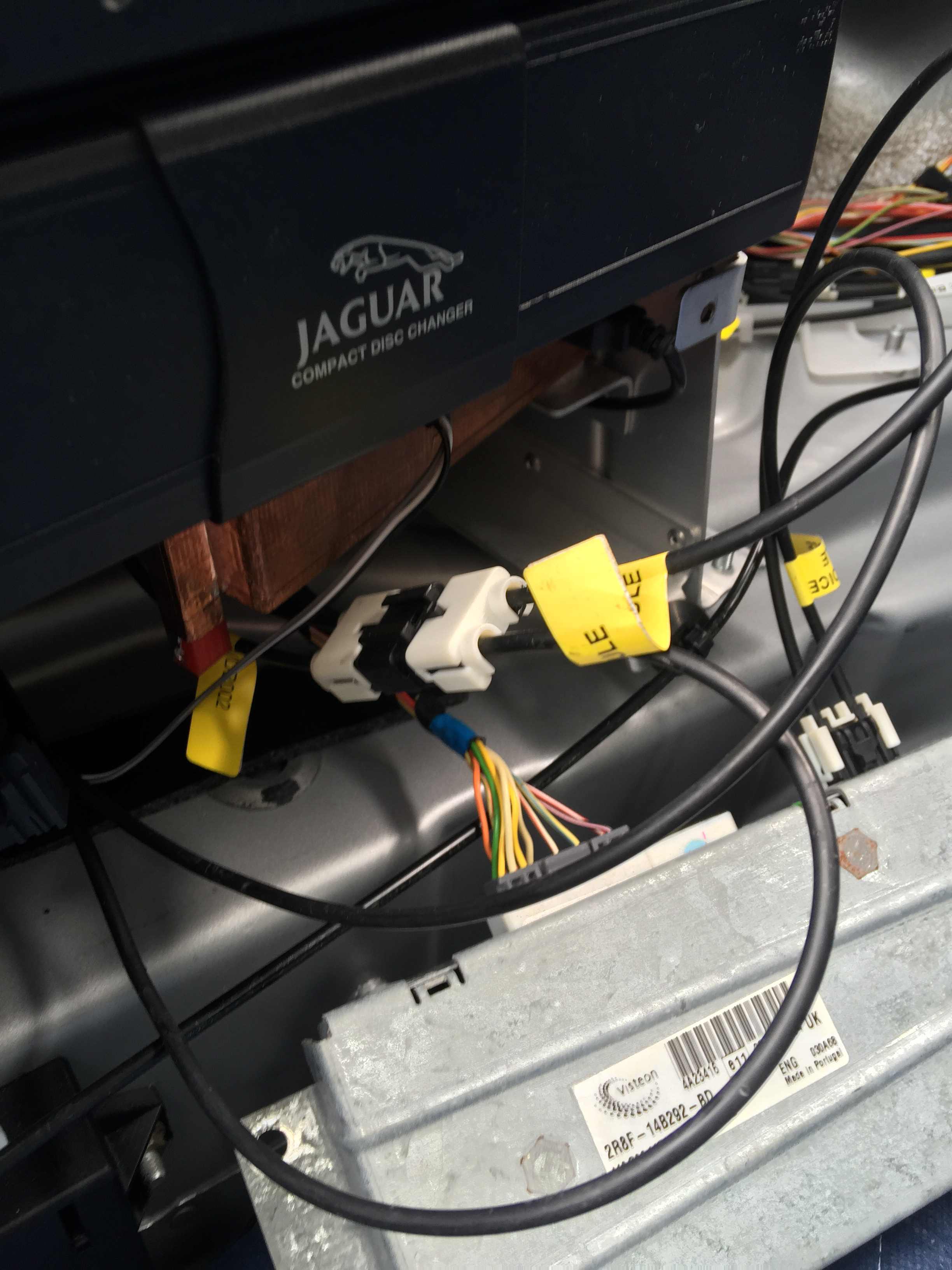

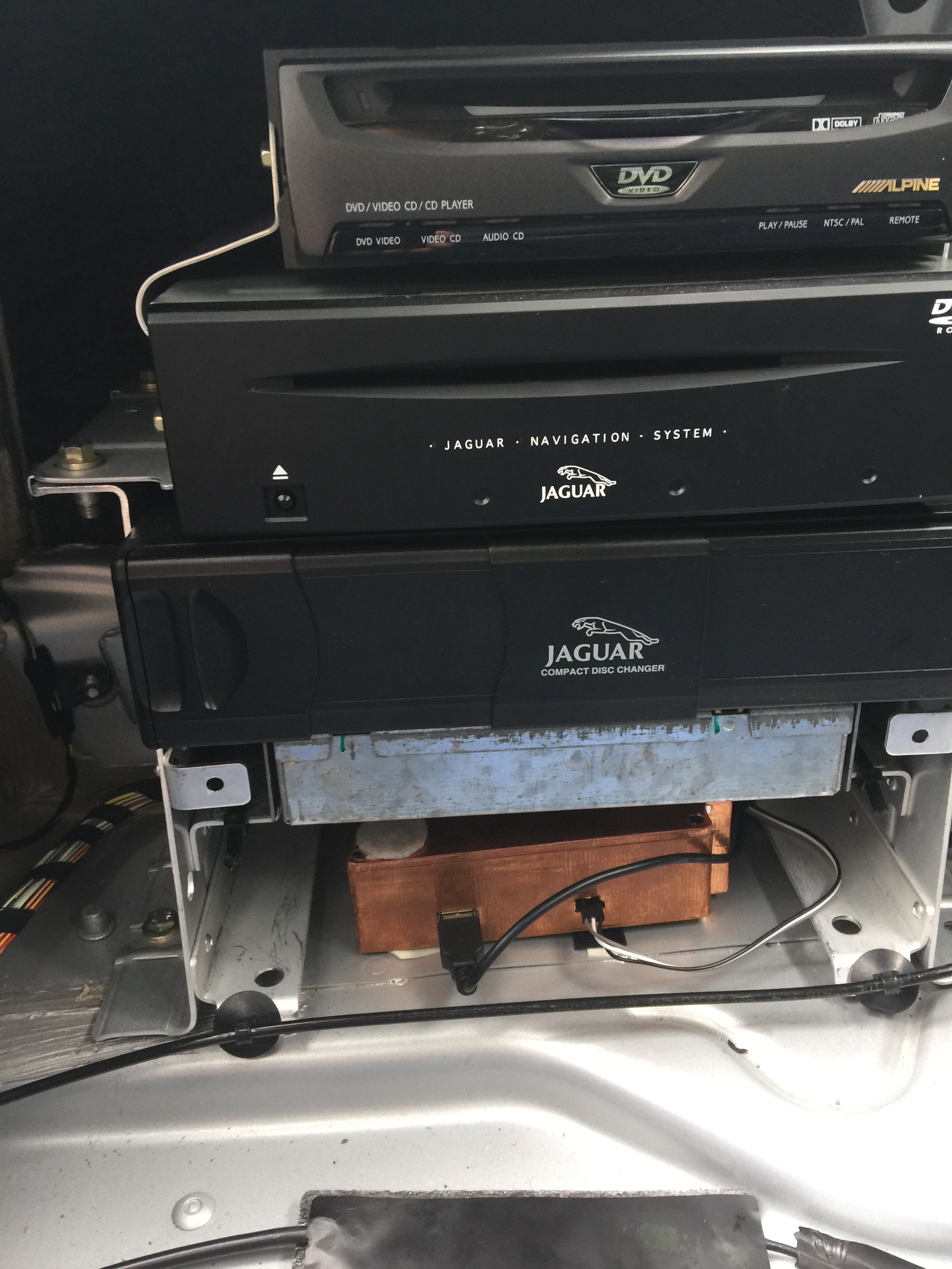

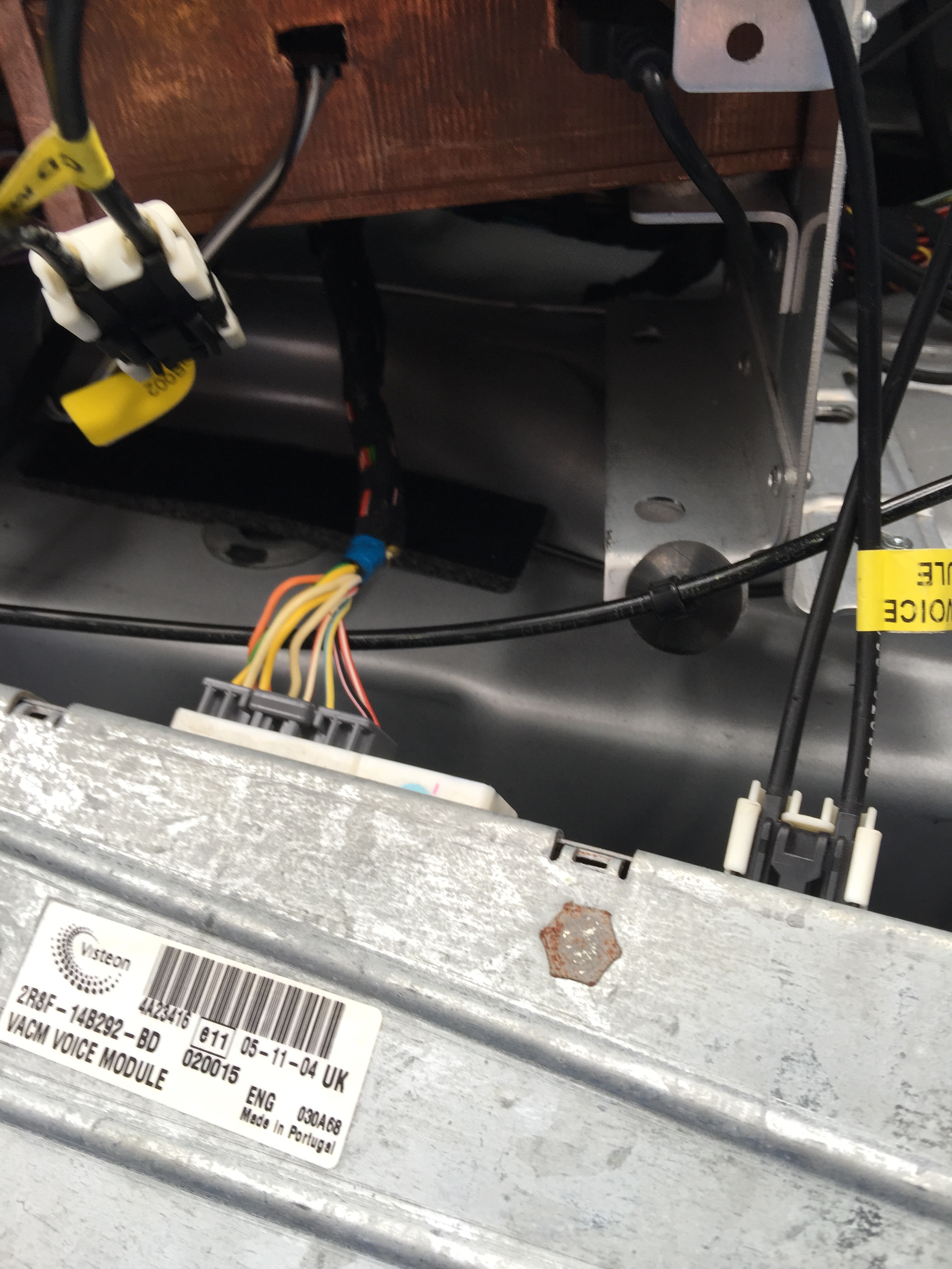

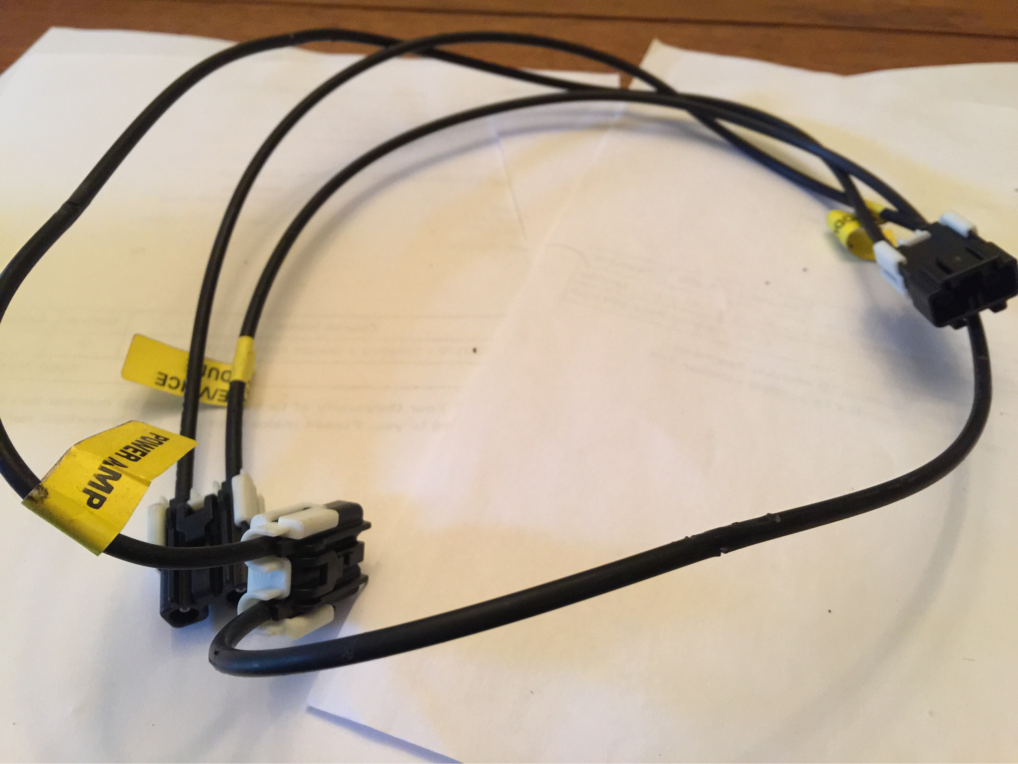

Today installed VACM in the 04 XJR. Just wanted to report that I created a 'Y' optical cable instead of cutting apart the cars optical loop.
For those out there that may want to add veffrmov's kit or telephone or whatever, you can create an optical 'y' cable to extend your optical ring.
See pics of existing cable with female and two male connectors.
See added VACM on 'Y' cable.
