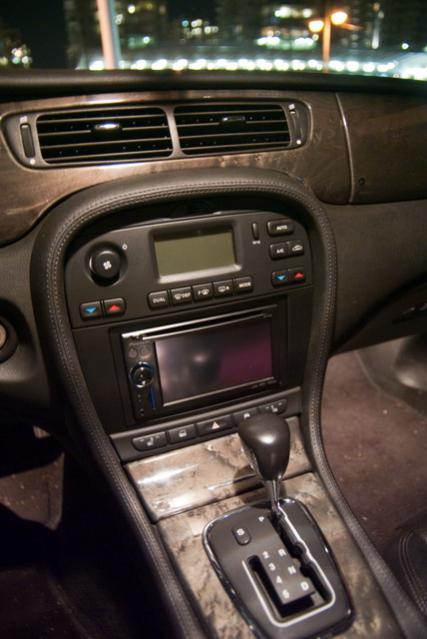

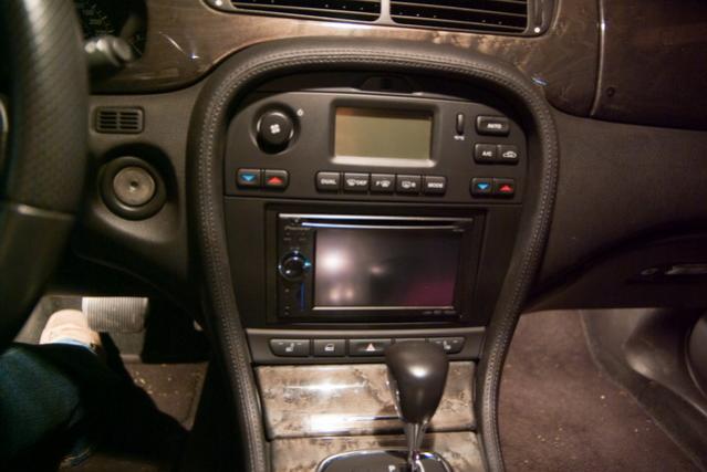

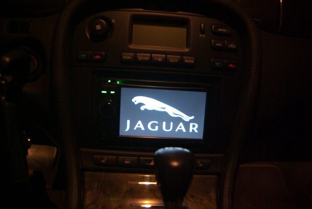

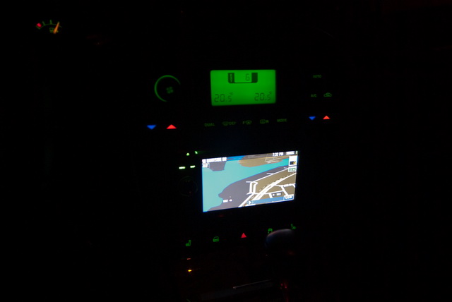

Here're we go.
I placed the BT mic (Garmin's) on the dash currently. I'm planning to move it to overhead console later. I heard that would have better sound.
Attached Thumbnails Pioneer AVIC-x710BT on S-Type "Installed"!-20100209-imgp6452.jpg   Pioneer AVIC-x710BT on S-Type "Installed"!-20100209-imgp6453.jpg   Pioneer AVIC-x710BT on S-Type "Installed"!-20100209-imgp6456.jpg   Pioneer AVIC-x710BT on S-Type "Installed"!-20100209-imgp6458.jpg   Pioneer AVIC-x710BT on S-Type "Installed"!-20100209-imgp6459.jpg

my mic is up on the upper console, seems to work very good from that location. I like the final look of your unit in there. Seems to match very well. How was the depth once you got the factory one out??? Was there enough room for cables and such???
Im looking at the new clarion piece (nx700) and i might just pulll the trigger on that.

I didn't have problem with any depth issue. There were plenty of room when I organized the wires to side and bottom of AVIC unit. I placed the GPS receiver on top of the HVAC with metal sticker and place the excess wires on side. I don't use second harness (for AV in/out), so I had to worry about main speaker&power and antenna harness.
I used Garmin external mic. I read from Avic411 forum that Pioneer mic isn't the best. And my wife complained about the F500's built-in mic. Since it's only $11 USD shipped, I purchased two.
http://www.amazon.com/Garmin-Externa.../dp/B000F7A832
I haven't had chance to really test it yet. I will let you know if this is actually better than Pioneer mic.
I ran the USB cable to ash tray. Since I don't really need the ash tray I removed the tray.
