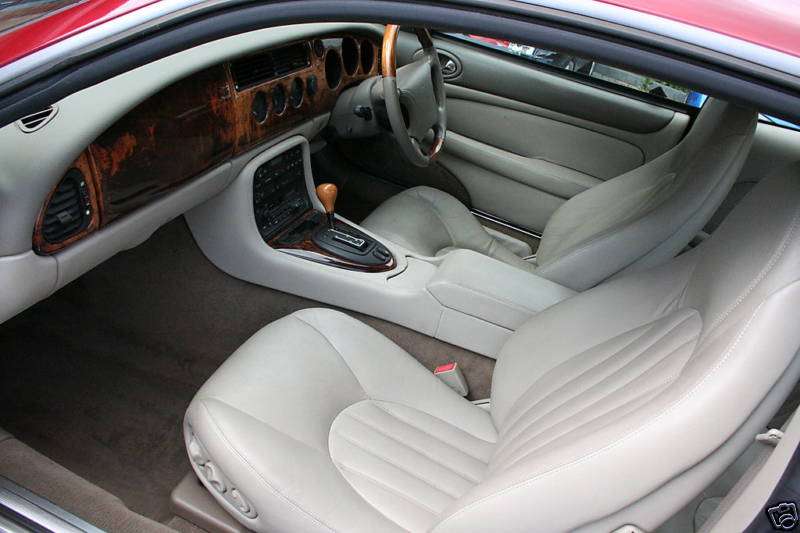

Hi Guys
Yes it is registered as Oct 96. I might be describing it wrong sorry about that. I don't have a manufacturers fitted Nav system in the 96 XK8. You are correct there is no wooden veneer on the radio/climate control center consul. I was wanting to remove the existing radio tape deck and fit the head unit like yours and if it was possible to remove the middle section of the wood veneered dash that has the 3 dials and two vents and replace it with a wood veneered panel from a later model XK8 that has a factory SAT NAV unit fitted. Obviously I would have to replace the whole wood veneered panel from one side to the other so that it matches. Just wanted to know if it can be done ie are the physical dimensions the same as the 1996 panel/dash wise. If this does not work I will have to settle far a all in one Kenwood with a flip up screen and touch control that has SAT NAV, Blue TOOTH and controlled from the steering wheel controls. I hopefully have managed to attach some photos, she soon will have the new type front bumper with mesh grill fitted, serviced, blow by test, water pump, Thermostat, tensioners, bonnet with vents and a new ICE fitted/done. She has done 110000 and I have just recently bought her from a really friendly and helpful chap in Kent who owns a car outlet, Leigh Clarke he has been a great help to me and will have all my little requests sorted out before I pick her up. Cheers Ken

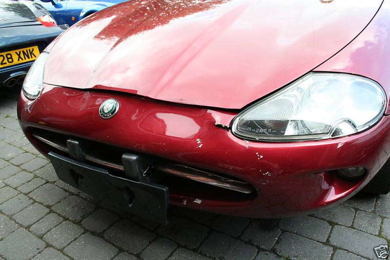

beautiful car kmack, what happened to the front end? Did you get into a fender bender already?
Regarding you're question, wouldnt you like to keep your guages up there, isn't one of them a oil pressure? To answer your question, you could replace all of your veneer, but the addition of a nav screen and those panels will be expensive. You won't have a true navigation option via jaguar parts, but you could power the screen and use it for DVD playback and any other video need you might have, like my Garmin NAV unit that I installed.
If I were you, i'd remove the old deck, get a DVD/NAV/MP3 flip out screen unit (the kenwood i'm not familiar with, but would work, Im sure). A double-din will not fit. Any good car audio shop can get fabricate you a faceplate. If you like the way mine is flush when mounted, request that they take a little extra planning and do a recessed mounting plate, then make the trim piece as my guys did. Just be careful with the controls just above the deck and make sure the unit you choose can come out, flip back and not hit any of the controls (not to mention your gear shift) It may be tight, but I have seen that exact setup in our XK8s.

Many thanks to you and I think you are right I will go for the flip out Kenwood with Nav facility. I see one on the US ebay for $740 complete and brand new. The car was like that when I bought it and is getting repaired as we speak (or I hope so that is). I did get a good deal though!
